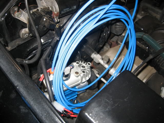

Well, I got it all together (pretty much). Mounted my compressor by the master cylinder & pressure tested it for 20 minutes & it never kicked on again. It was too hot to wait outside for it to eventually come on.....I figure it's good for now.

Yeah i thought about it & I discounted it because the wiring loom wouldn't be long enough #1 & #2 the noise of having that rather loud compressor anywhere inside the vehicle would be annoying; for me at least.

How can you stand the noise of having that thing in the cab? My CKMA12 is L-O-U-D! Even under the hood it's still startling to people who aren't expecting it ( I tested it on strangers in parking lots yesterday & my wife & kids
