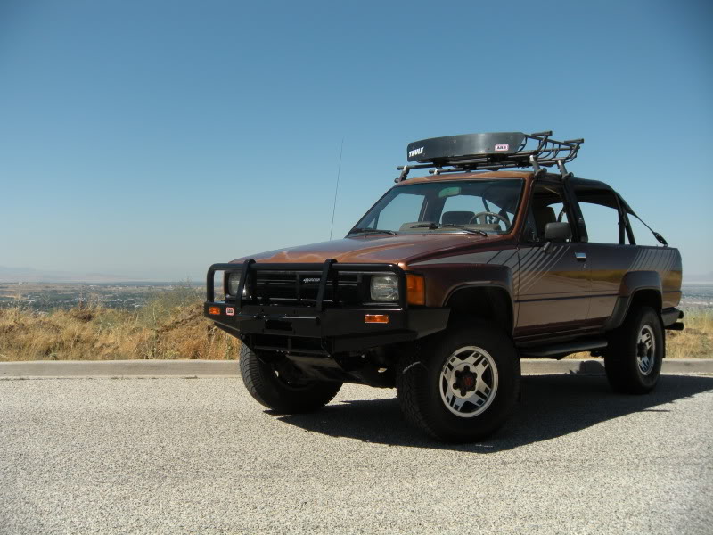

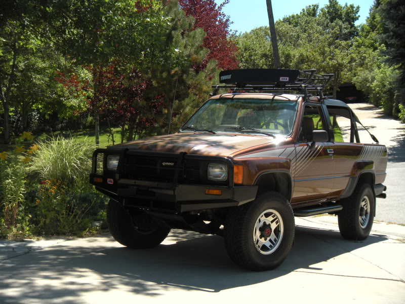

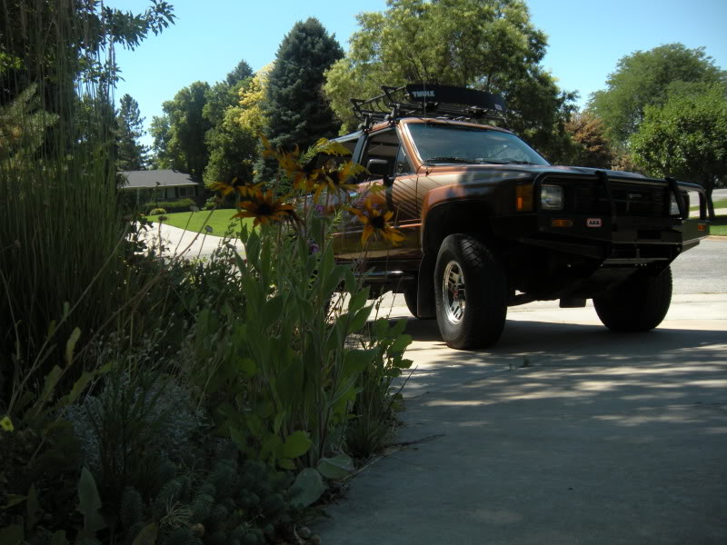

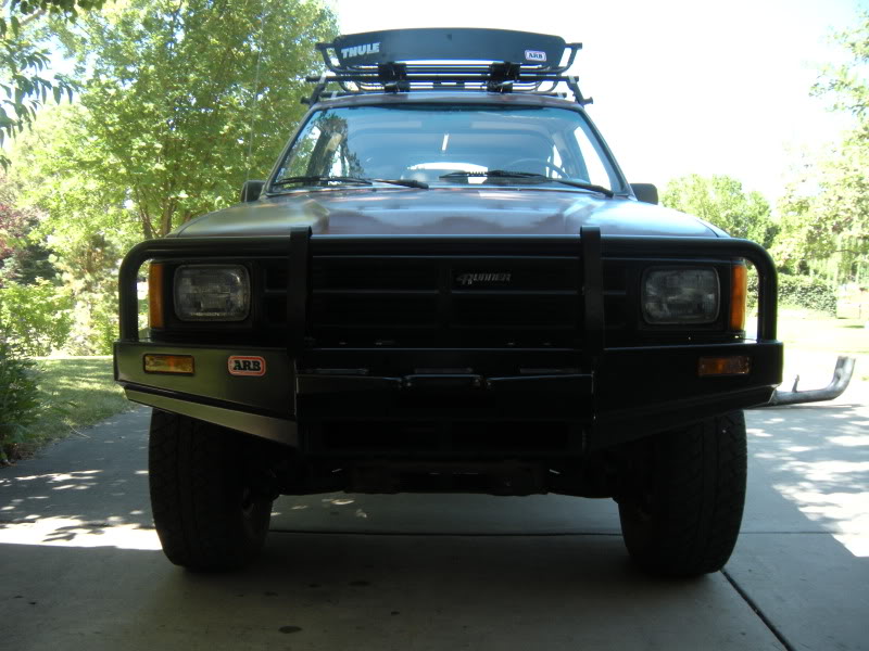

It took me and a friend around 3 hours, but it's on.
Next comes the winch.
I love that 4Runner.
Heres Some Pictures:

It took me sometime to justify buying it, they're so expensive.
But worth every penny!
ARB truly makes a quality product.
The only issue was knowing where to place the hardware.
The ARB manual isn't very helpful. The manual basically says "take the bolts and washers and us them somewhere".

I can't believe you mounted it without the winch?! You'll definitely have to take it off again to install the winch, it would definitely be easier to do it that way anyway...
I love my ARB. It fit like a glove and looks so much better than that useless flimsy POS stock bumper... And yeah the ARB instructions and somewhst to be desired, you'll find you're pretty much on your own to install the Winch. You'll have to drill holes in the roller fairlead if you go with a metal rope style which I found out. If you're wondering what the massive like 6" long bolts are for they're actually to install through the two vertical rollers of the fairlead. Use these and maybe a ratchet strap to locate and hold the fairlead tightly in place while you drill the holes through the back of the bumper for the winch mount bolt holes through the fairlead. Unfortunately the fairlead is generic so it doesn't have the holes for this installaion. Took me about 6 hrs to install both, but I was really taking my time. I loved how my ARB came with the turn indictator lights, from everywhere I read I needed some 89-94 truck or something lights to go in there, it was a nice surprise!

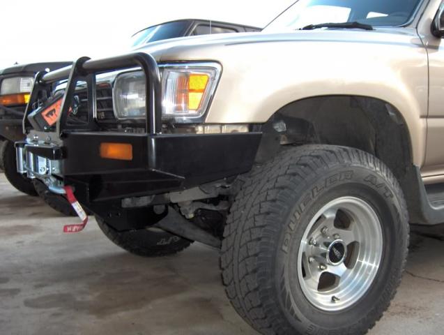

Originally Posted by OutlawMike
I did find on the first gen 4Runner that the bumper fit too close to the fenders. It hit my fenders on each side. I went ahead and installed a 3/4" body lift to get clearance at the bumper and for various other reason.
AHAH! So it's you damn first gen guys that ruin it for us 2nd gen'ers? It's the exact opposite for us, it's too far away from the fenders for my liking. I had to go ahead and paint that part of the fender black to make it not look so obvious. I feel that did the trick though, looks fine now.
In fact I've attached a pic to illustrate my point. It's a pic I found on google image it is NOT MY TRUCK. It's the only disappointing thing about the ARB for me. Wish they would have made it exclusively for 2nd gens, screw you first gen guys I'm happy I found that picture though at least I knew it was gonna be something I'd have to deal with.

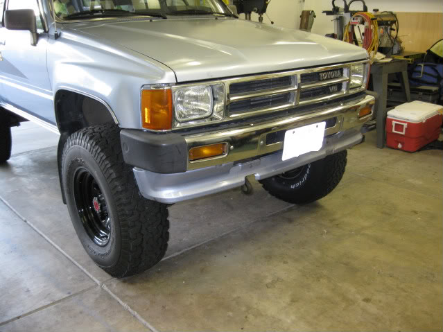

Originally Posted by Fink
Bumper makes it look like a whole new truck - ya got any before pics?
Fink
Before:
After:
