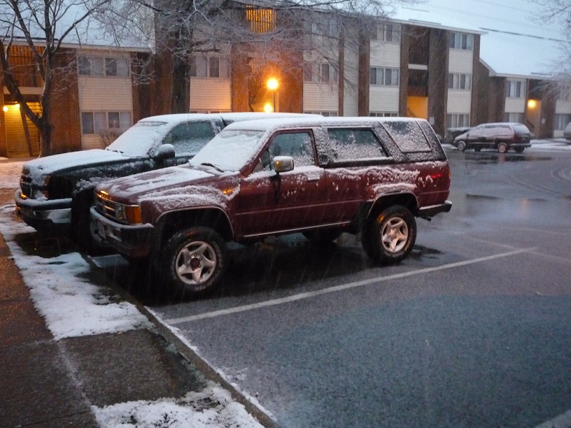

Here is the rims I am talking about, and the stance on the truck. It has just a slight amount of rake in the rear, but it seems to be normal for most trucks, of course most of the 1st gens I see are sagging in the rear.

So anyone have any experience with this?
