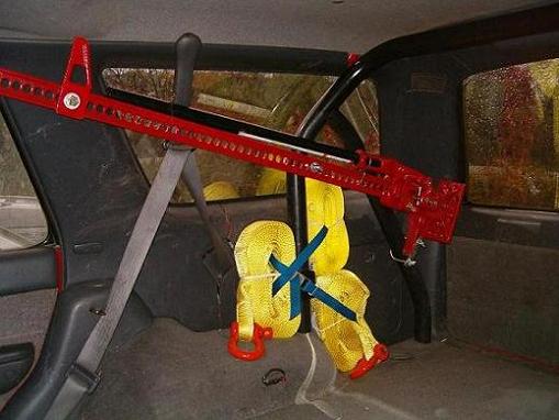

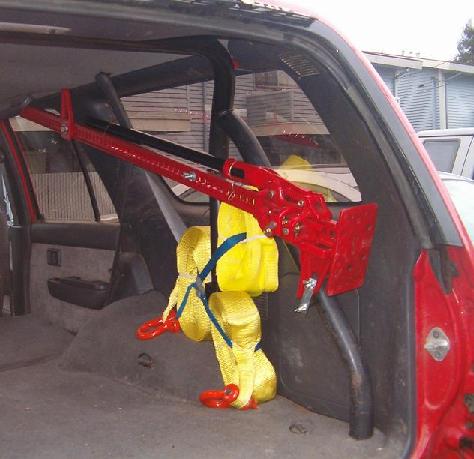

don't know if yer only into the swing away mount, but...
I got me a roll bar from a 1st gen and threw it in the back of my 90---tight squeeze, but still got in in. I used the factory threaded holes in it to bolt my 60" HiLift to it...it takes up very little room and it's inside from the external peril of environmental elements and human thievery, plus you can hang hella stuff on it

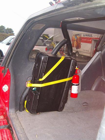

ya I got pics
just hadta cut the side panels in half to fit it around the roll bar...went right in place...bolted the roll bar to the floor, and hafta get around to bolting it to the frame underneath for extra strength.
hardware needed is a few bolts (one u-bolt), washers, (wing) nuts, nuthin fancy. but a kick ass place for the HiLift & tow straps, and got the tool box and fire ex. on the other side to boot
