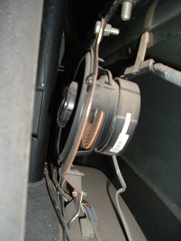

Well, I'm embarassed to took so long to post this pic, but here it is :pat: this is the bracket to replace the stock ones in the rear panels of my 1st Gen.
Attached Thumbnails anyone have/install REAR speakers on a 1st gen 4Runner?-rear-speaker-copy.jpg

Here's a view from the side
Attached Thumbnails anyone have/install REAR speakers on a 1st gen 4Runner?-rear-speaker-side-copy.jpg

Well My 85 has the same rear panels and no speakers. I bought som 6.5 inch Rockford Fosgates an I was wondering how I was gonna mount them (heh-heh huh huh....I said "mount"...heh-heh-heh...).
Great idea Erich! Thanx for the pics!

Yeah, I wish I had gone with something larger like 6.5's or 6x9's, but I bought my speakers before I took the pannels off and saw what I was working with. Show us what you end up doing!
