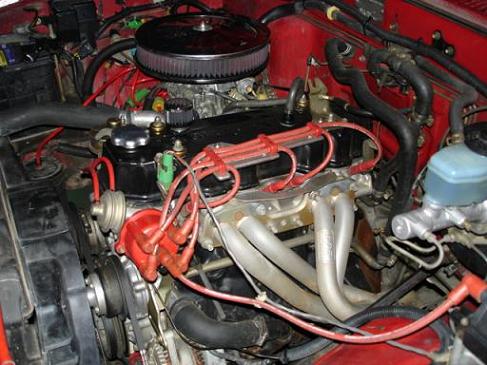

I've got:
Ceramic coated header
Forged Pistons w/Total Seal Gapless rings
Cro-moly Rods
Stroker Crank
Double Row Timing Chain Kit
Split Duration Cam
basically an LCE stroker short block I built from their parts
Love it, wasn't cheap though. But my Baby deserved it after twenty faithfull years of work and play.

DYNO?
It should be noted that forged pistons are overkill for a naturally aspirated motor, but they're used on the stroker as you have to do custom pistons anyway... Rods - same deal, they're more than strong enough for a naturally aspriated application...
Typical places to spend money - headers, exhaust, & mild head work...
