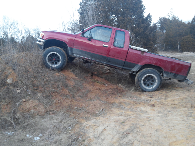

I dipped the bottom of my truck 1.5 years ago, and haven't touched it up at all. I also did my side mirrors and headlight bezels, and its holding up fine. The secret is to clean it with alcohol or wax and grease remover, and do several light coats. Too few coats and it'll be a pain in the ass to remove, the more coats, the easier it peels. Sure, it's worn and chipped in some spots, but it's nothing 10 minutes and some plastidip can't fix. As a whole, it's held up damn well, only showing wear where my boots hit getting in the truck and where it's rubbed up against stuff off roading, which is impressive considering I don't have any mudflaps. Its easy to touch up and actually comes clean when you wash it compared to Bedliner, which still shows dirt and mud stains even after a stiff brush. And yea, it holds up to chrome just fine
Attached Thumbnails Anybody plasti dip chrome bumper and grille, long term durability?-forumrunner_20140210_105404.png   Anybody plasti dip chrome bumper and grille, long term durability?-forumrunner_20140210_105418.png

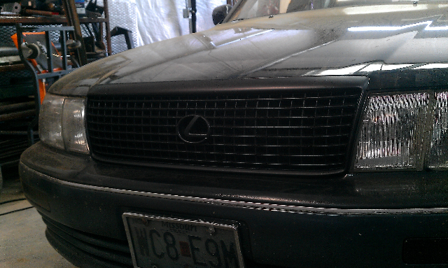

Here's my Lexus grill after 6 months
Attached Thumbnails Anybody plasti dip chrome bumper and grille, long term durability?-forumrunner_20140210_105844.png
