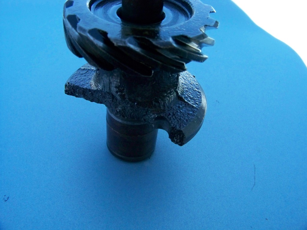

Found the distributor drive broken and the cam sprocket dowel sheared.

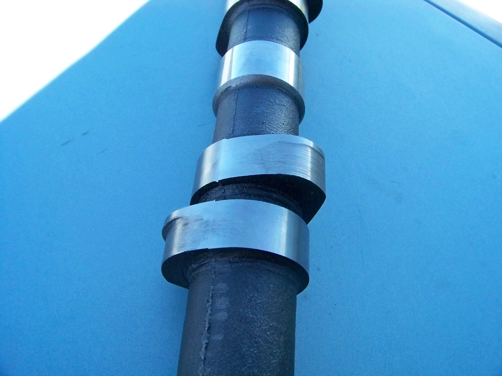

Never seen a camshaft wiped like this one. All lobes wiped but several with near 1/8 inch gone. WOW!!!

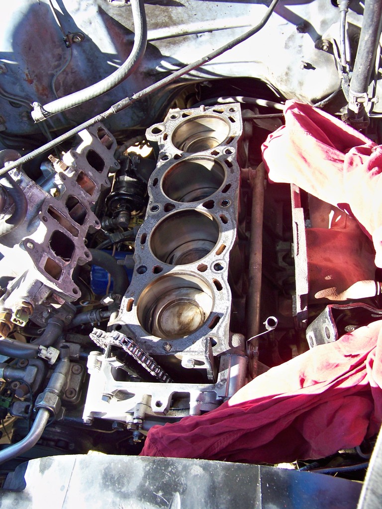

There were fairly light indications that the intake valves kissed the piston tops when the timing let go. The aftermarket casting head is at the machine shop for bent valve inspection and freshening.
The pistons show 1mm oversize and the bores look good.
Gonna drop the front diff and pull the oil pan for cleaning and a look at the rod bearings since so much chaff from the camshaft has passed into the engine; not to mention finding the large missing chunk of the dist drive gear.

can't believe the camshaft tho! and how did that distributor break like that.

dang!! mods need to rename this the ugly camshaft thread!
i had to deal with flat cams on the old aircooled vw's, seeing it on these trucks makes me real nervous.

Nice 4Runner. Saw 22RE cam lobe suffer same as yours but never pulled distributor to take a peak. It was the lobe nearest distributor that was worn and we had just replaced head with a reman 30 days previous. Any idea exactly how/what happens that causes this?

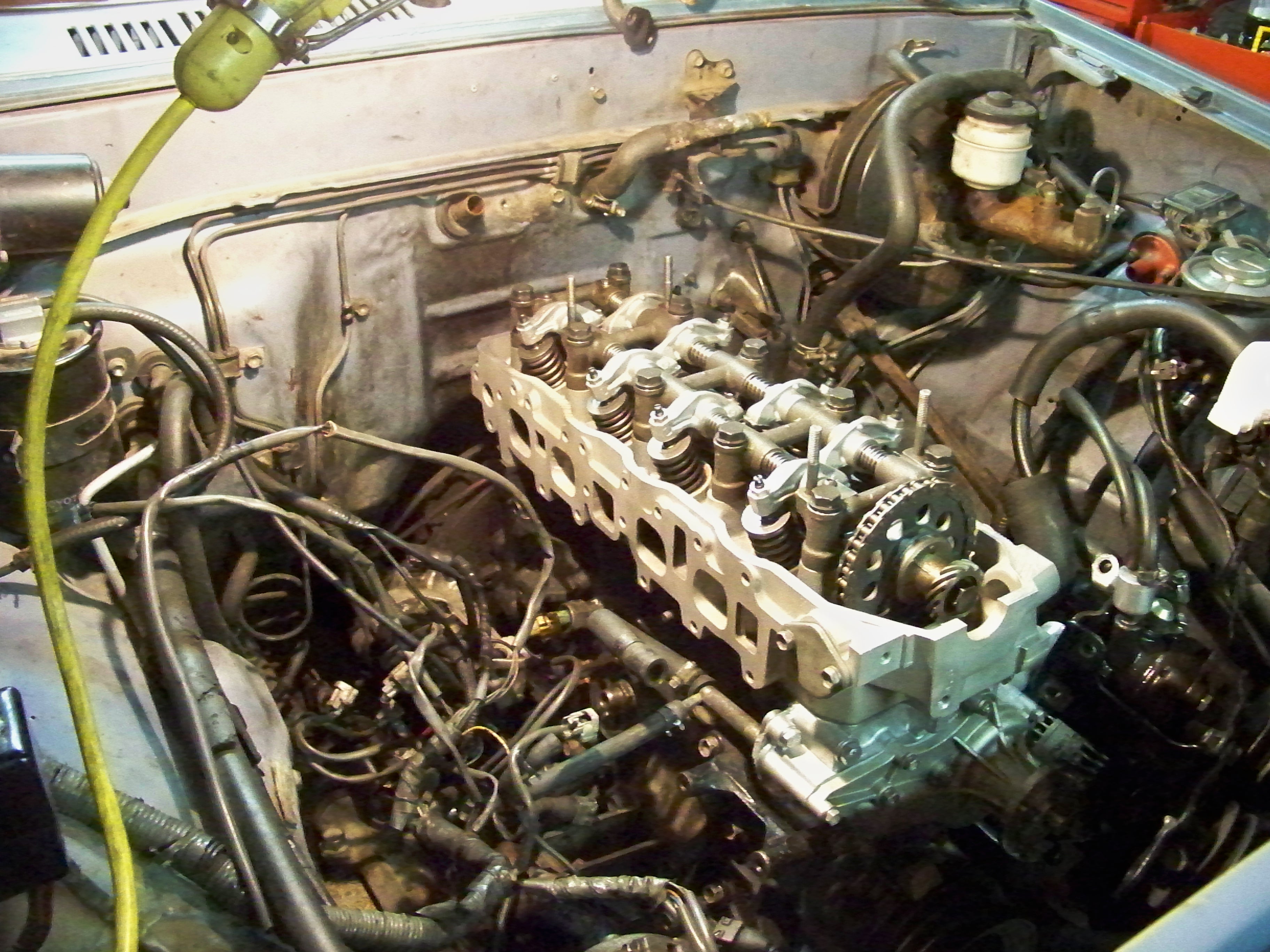

Waal... I been peckin at it. Timing cover and head went on today.
In-frame overhaul including new NPR pistons and rings, King rod and main bearings, valve grind, new cam and rocker arms, timing chain/gears, oil pump and timing cover.
Gonna do some soldering/wiring harness rehab and other general underhood chores.
Have about $700 in machine work to head, new engine parts n gaskets, not too bad.
Might get her running by new years, if I don't decide to go camping over Christmas.
