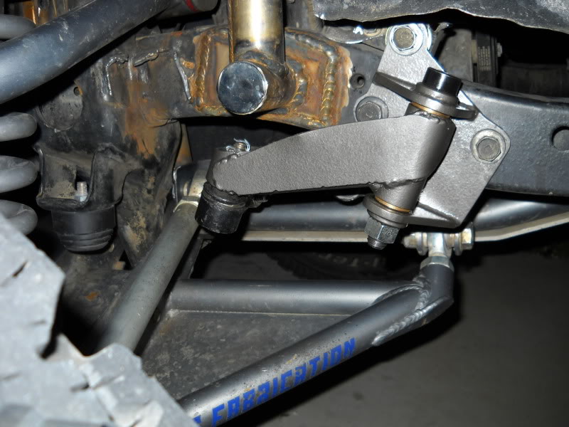

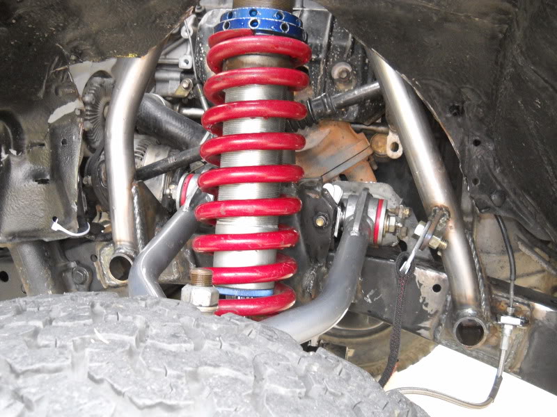

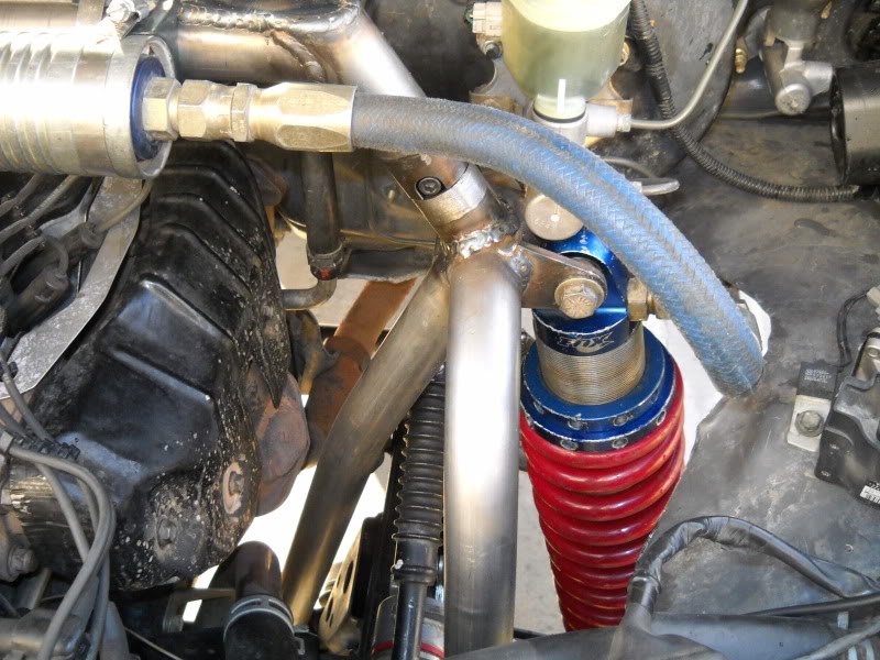

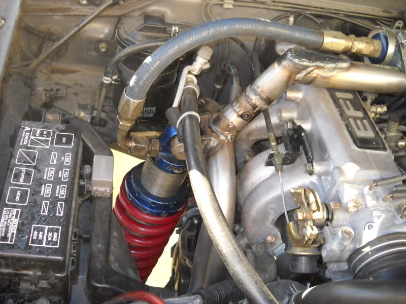

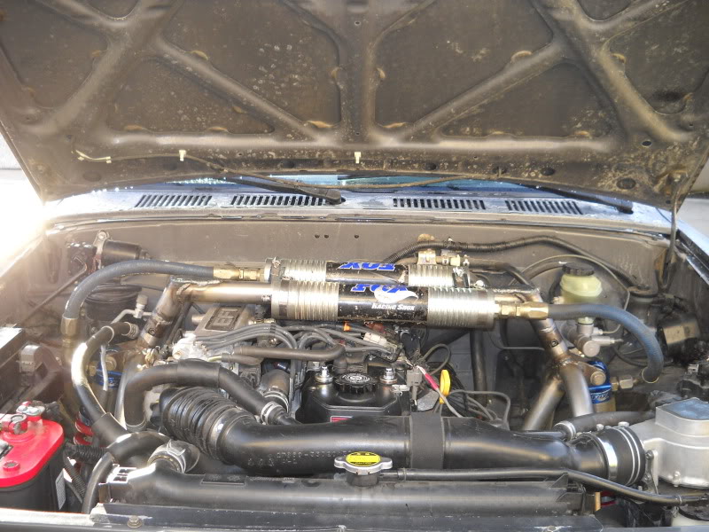

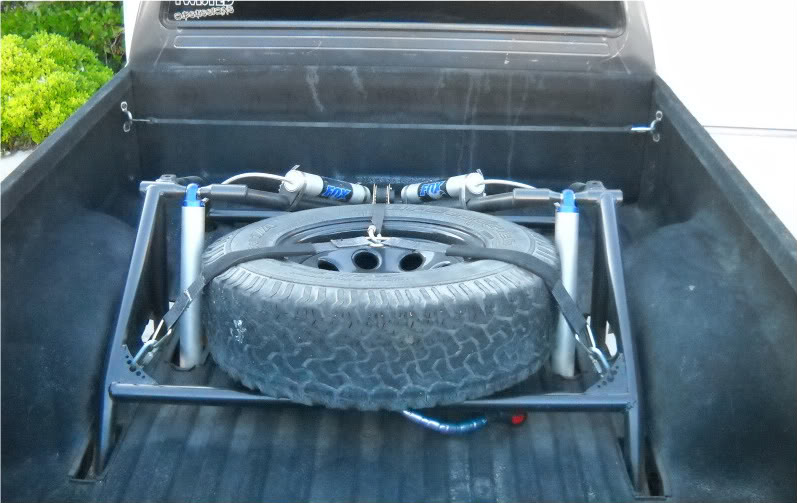

Both of those trucks look very nice! I love that long travel on the front Robert, but how is it to work on now? (Like doing valve adjustments) Do those reservoirs get out of the way very easily? And that coil pack is unreal. Does it ride ok, or is the back super stiff?
looks like to me the cross bar for the reservoirs is removable see the allen bolts?

Old May 16, 2010 | 06:24 PM
Robert m's Avatar
Joined: May 2006
Posts: 1,979
Likes: 143
From: Apple Valley, CA
the reservoirs come off with 2 hose clamps and yes the cross bar comes off if the engine needs to be worked on. we used these tube clamps from ballistic fab http://www.ballisticfabrication.com/...mp_p_1467.html
