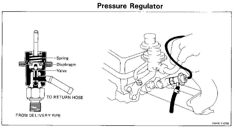

I just checked the hose that leaks gas.It's up against the firewall on pass side.Bolted to firewall.I followed the line and it runs back to the gas tank.Looks like it goes to the top of the tank where the fuel pump is.The other end that is in the engine bay is still loose.Thats where I seen gas dripping out of.Anyone know where this hose should be plugged into?
I see no empty hose nipples on fuel rail and on the intake.Apparently there is a hose on the engine I put in that is already hooked up going nowhere but I cant seem to find it.Need to know where this fuel line from the gas tank goes to on the engine.Thanx a million and pics of where it goes would really be great.

Do you have a fuel return hose going from the fuel pressure regulator to the fuel tank?

I guess thats where it goes.Man I appreciate all the help.Couldnt find that hose for nothing.Ill look tonite when I get home.

The hose that was leaking gas is fixed.Thanx to everyone.I ran the truck with the other engine tenant up the road it ran great but when I got back I checked it out and sure enough the head gasket is blown.I took the head in to get it looked at and I got it back and put it back on with a new head gasket. machine shop said it looked really good. they took off 5000 of an inch and said it wasn't in too bad of shape.But now after installing the head gasket I am having a problem. I can't get it started. the only thing I did different was to install new terminals for the battery. all it does is make a whining noise sounds like it's coming from the starter relay. I am so frustrated with this little toy right now. battery is fully charged and I don't know where to look from here. before I took that head of it started right up first crank. headlights ham radio work but when you turn the key for the starter nothing I check the plug going to the starter and it is not getting voltage.12 volts to the big wire but when I turn the key to start no voltage to the little wire plug going in to starter.I never even looked at it today just frustrated.HELP!!!!!

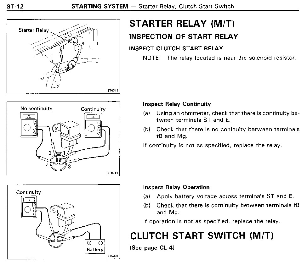

Well that does sound like there is no voltage from the little wire to the starter solenoid. Maybe the starter relay is involved as you first thought. If you were very careful you could make a hot wire to plug into the starter and touch on the battery post to make sure the starter turns. Be sure the truck is in neutral and the parking brake applied.
