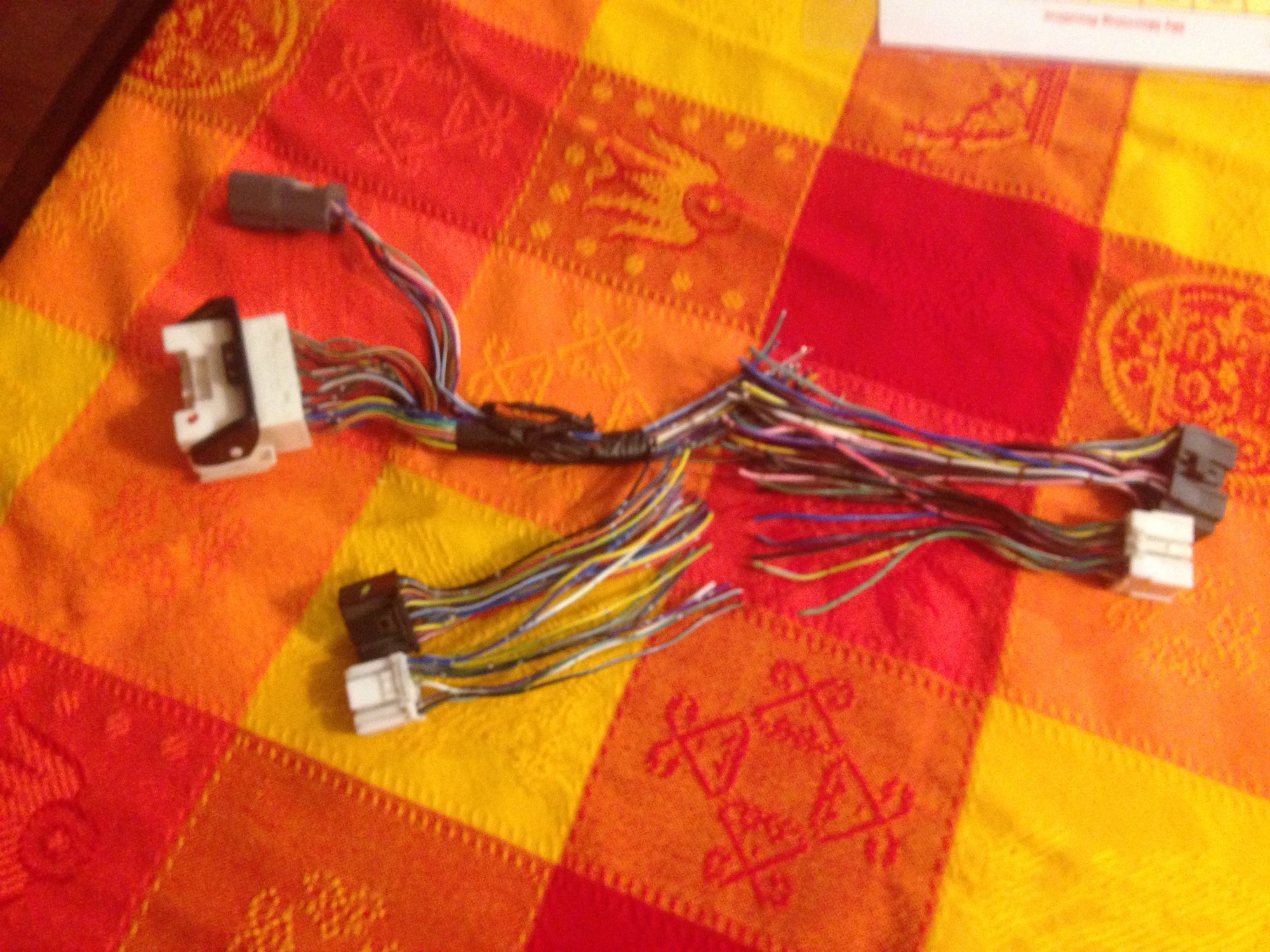

I think you are misunderstanding what is being said. You do not need a DASH harness at all, you need a engine harness and ECM, then you use the dash plugs aquired from the donar to make a conversion harness. So, having that said, have 2 options.
1. SEARCH the 3.4 swap section and you will find a how to on how to convert an auto engine harness to a manual harness, and buy a manual 2000 ECM (99? and newer auto and manual use same ECM plugs).
2. Find a new 3.4 manual engine harness and ECM, remove the harness from your 3.4 and install the new manual harness.
After you decide which direction to go, go to TIS https://www.techinfo.toyota.com/ and get a 2 day subscription ($15). Download the EWD (electrical wiring diagram) for the donor and the recipient vehicle. Be sure to grab the year you have, the year prior, and the year after just in case. You would be surprised how many vehicles are build with older or newer harnesses. My 89 uses a 90 harness according the the EWD.
Then build a conversion spreadsheet, and finally a harness. Here is mine for an example. Good Luck!
Plugs from donor 90 pickup engine harness and 99 4Runner ECM and Body harness.
Ta Da!

Oh and FYI, 90 pickups and 4runners will be very close when it comes to wiring, and 98-2000 4Runners should be the same (Manual that is) so your harness could look very close to my spreadsheet, but get the EWDs and confirm. Search the 3.4 swap section, that's how I sorted all this out. Seemed scary at first, but now that I have done it there is no way I would ever buy a harness!
