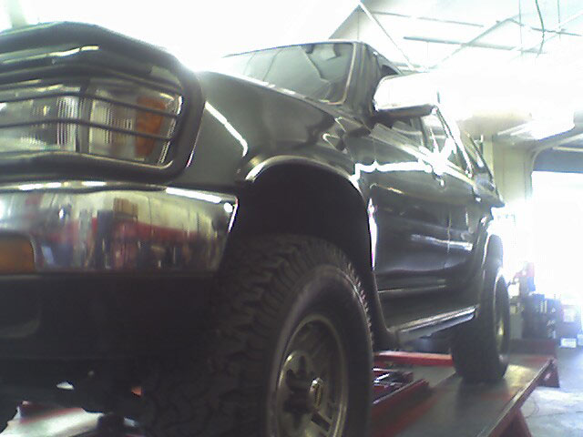

Just my 2cents about the firestone lifetime alignment, I bought it about 6 months ago and had my 2nd gen aligned 3 times already. I think that chickenlover's advice on the IFS truss for the 2nd gen is SPOT ON. I personally really recommend the sonoran steel IFS truss over the downey, it is really beefy IMHO. After I got that in there my alignment didn't budge and last time I brought it in it was perfect from the get-go.
they have the laser alignment machines and they are friendly and professional. I think it depends on which firestone you go to, but for the price, (I think I paid less than $100), and the fact that you can get alignments anytime you want, it pays for itself after 2 times.
that said, I totally agree that some firestones won't be any good and will probably wreck your vehicle. this goes for any chain of stores though, I would say that it's a worthwhile investment, just shop around until you find a firestone that you like.
at the end of the day they are an affiliate of Ishibashi, Bridgestone, a major, major japanese multinational. they are the real deal, I feel bad that you found some slackers at your firestone. rest assured that this is not a top-down thing from the japanese zaibatsu, it is a lazy workethic thing from the shop end. If they had adhered to the japanese work ethic they would be in the shop at 6am chanting the bridgestone motto and vowing to serve the customer to the best of their abilities. I have seen this, it is extremely weird but also impressive in a way.
"Okyaku-sama wa kami sama desu! " (customer is god).
www.bridgestone.co.jp
plus, you get to support all the cute Bridgestone girls if you buy a lifetime free alignment! What a bargain!!
included some pics of my 'runner being aligned at the firestone westlake (very good, they let me watch the computer and lasers until everything was very solid back in spec). highly recommend sonoran steel truss. nothing moves!budbuilt skid also keeps the front end solid too
taiko
