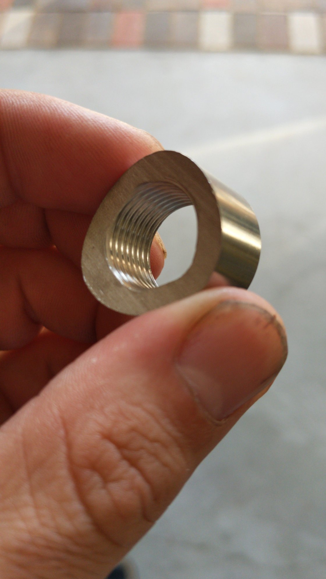

The bung
Hole drilled, bung welded, wideband 02 sensor from AFR kit installed

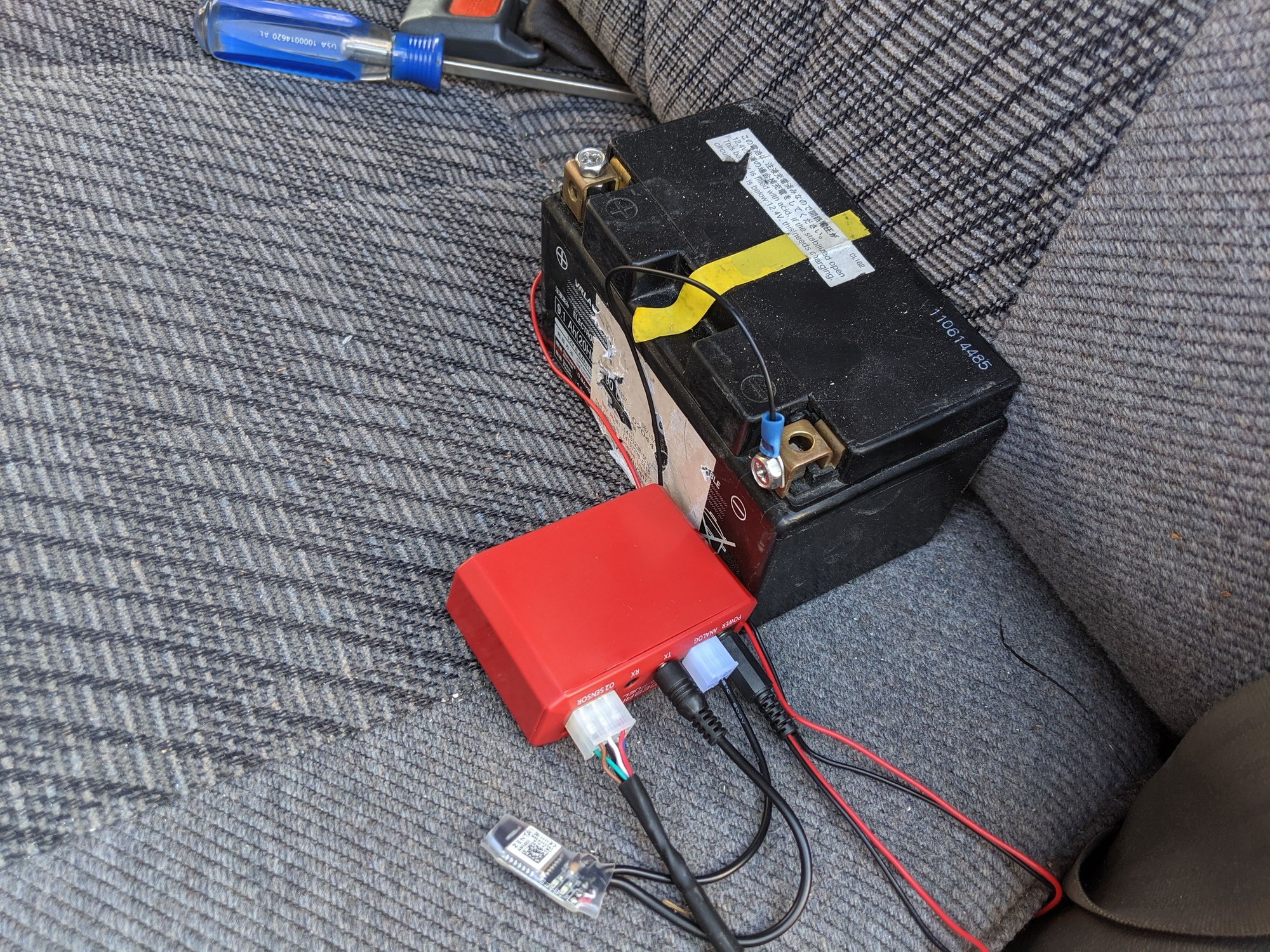

The PLX for the AFR kit. Plugged in is a bluetooth chip. Outputs information to my phone. Motorcycle battery for power supply.
