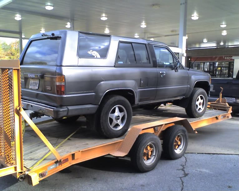

by the way, here is the truck in question.
