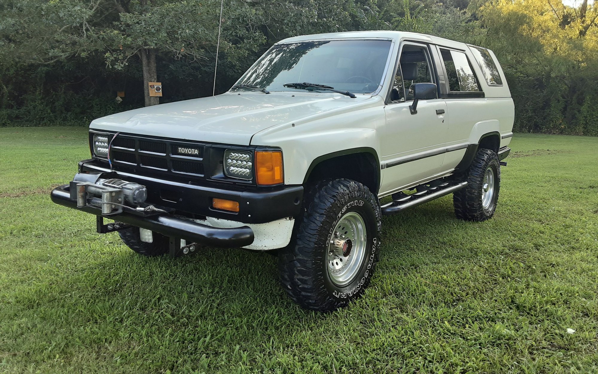

I had seen in many places about the possible power gain by adjusting the spring tension to richen or lean out the mixture. Mine an 1986 Runner 22 re 5spd with 269,000+ miles. Depends on where you look there are different oppinions on wheather to do or not and also on which direction to go with it. Hell i flipped a coin and went with counter clockwise ( to loosen the tension) . Most seem to at least agree on one thing and that is the number of teeth to go and that is 6. Some said had to adjust again. I in great thought and with the way my luck goes i went with 4 . Just to be on the safe side. With the possibility of engine damage. Have to say it made an all around improvement. The quickness of response when pushing the pedal. Has quite a bit more acceleration than before. Running 31-10.50-15s and have added several pounds with tube front bumper and winch, side rock guards, extra battery and so on. Would have to say it is like gained a gear as far as hill pulling. Im new to the Yota life and am learning from you good people. In my searches it is god to read and see what works and what dont so just wanted to put my two cents in and say that although may not work for all vehicles . For me at this time it is an improvement. Maybe could have gone further and gotten more improvement but why push my luck. Thanks. Evan.

Just How did you measure your added response and was anything else done at the same time?
