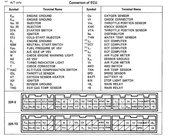

i noticed when i looked up the differences between the edu i got this diagram. maybe someone could chim in? i also have all of the truck wiring diagrams if some one would like to look at that as well if it helps.
