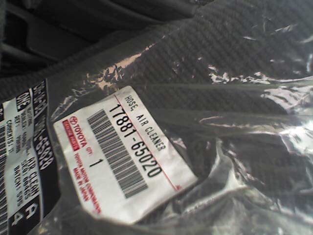

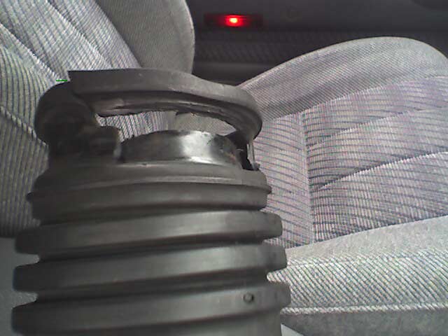

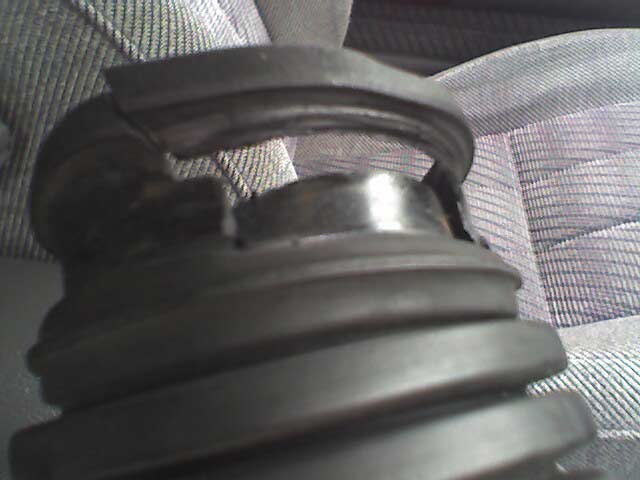

part replaced
i went in today and thanks to all your advice I was able to get a free rental car out of the bargain while they investigate further.
i told the manager that I wanted it to be running at least as well when it left, and he agreed.
also i said there was no relation between the part replaced and redoing the timing belt at 3.5hours x $100/hour plus tax.
I started the runner and she sounds FINE!????
what is going on???
here are the pics as to the tube that was replaced. it is the one that connects to the throttle body from the FIPK. they charged me $100 for it. it is $50 at 1sttoyotaparts. damn
car is still in the shop. tech will look at it again tomorrow morning and advise.
what should I do?
thoughts???

Wow... something's VERY wrong.
Going back to your original post:
(it was stumbling just a bit sometimes). I got a call later saying that he had found a vacuum leak due to a tear in an intake hose, which needed to be replaced.
If that tear was really on YOUR truck, it would be a lot worse than "stumbling just a bit sometimes". I doubt it would run.
So, reading between the lines of my own statement, I wouldn't think twice about someone having given you a torn hose that they had laying around the shop. That's BUNK. I think you're being taken for a ride.
On top of it, I would raise HELL about them doing the timing belt work. Signed or verbal consent be damned, it's just a wrong diagnosis to think that you could time an engine to get around unmetered airflow.

That hose looks to new to be original except for the tear.
The tear, melt, or excessive clamp pressure on the hose doesn't look right, is your intake system modified?
I paid $60 for a new one around 3 years ago.
It tore while taking it off the trottle body. Stuck because of the heat of the throttle body.
Your tear looks to be the other end where heat is not an issue.

tear in the intake hose
dude, this is toyota of seattle. they are supposed to be good.
so, basically, what I have is,
a huge tear that may or may not have been there when I took my truck in.
A part that costs $50 that I am getting charged $99 for.
1/2 hour installation for that ($50)
A $50 inspection fee.
Also, tax on everything.
next, a diagnosis that I need to have my timing belt redone as it is off a tooth and someone had overcompensated due to that hole.
