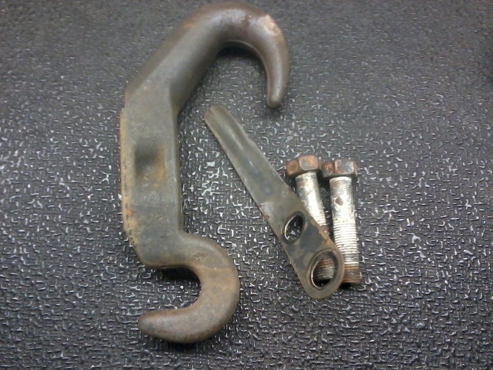

Here is the old one off, I still need to get the spring steel retainer back into shape.

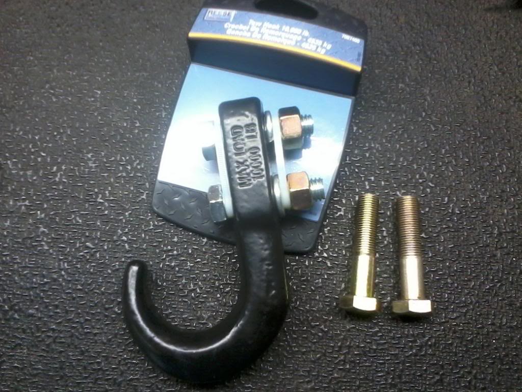

Here is the new tow hook and bolts. Plus you get a couple of spare bolts to trow in the trail box.

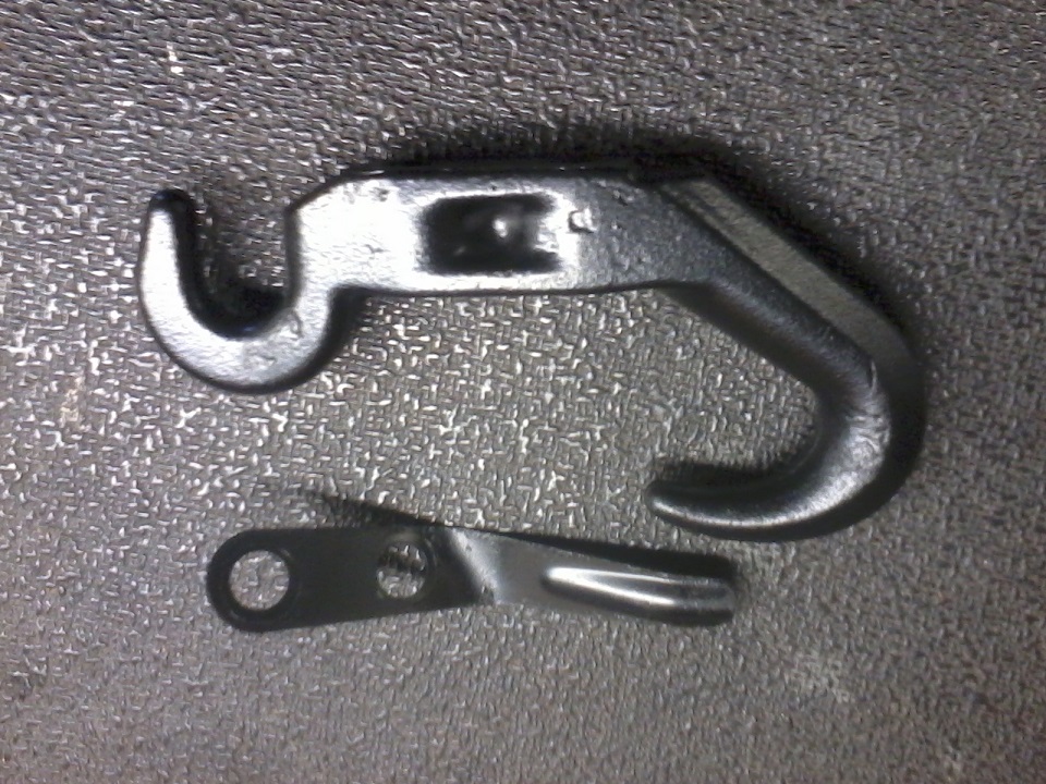

Decided to throw a little roll bar paint on the hook while it was off.

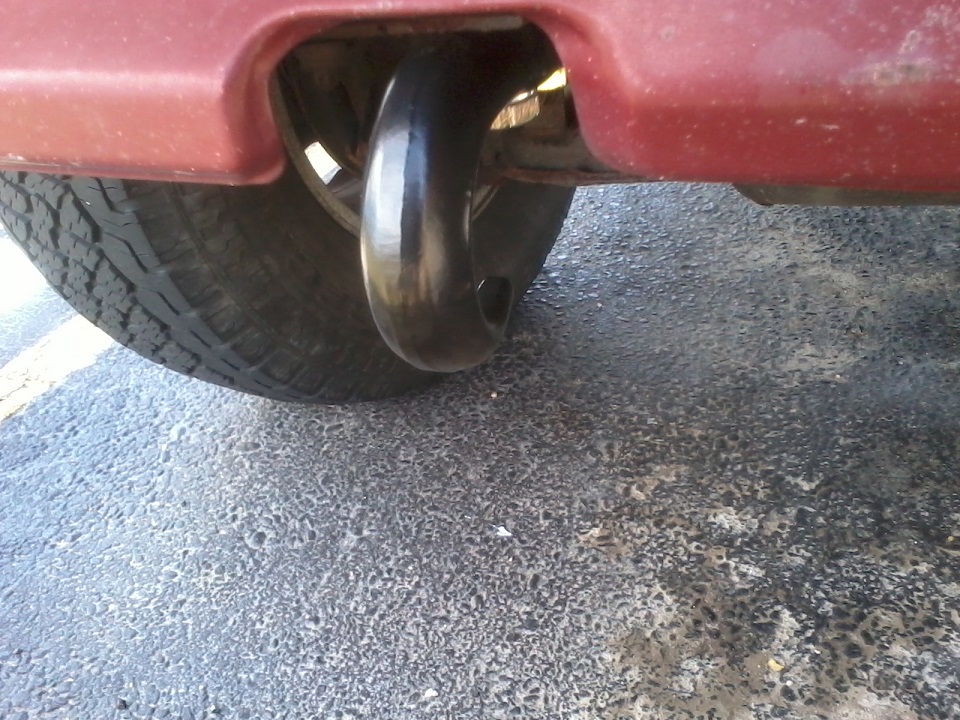

Here is the Reese hook mounted on the passenger side, the factory hook was moved to the drivers side.
Here is both of them. The ring that is on the drivers side can be put on the top of the tow hook. This will allow a ring for tow truck drivers to strap down on. I still need to fabricate a new spring steel retainer for the drivers side hook, and clean up the cut on the valance on the drivers side.
