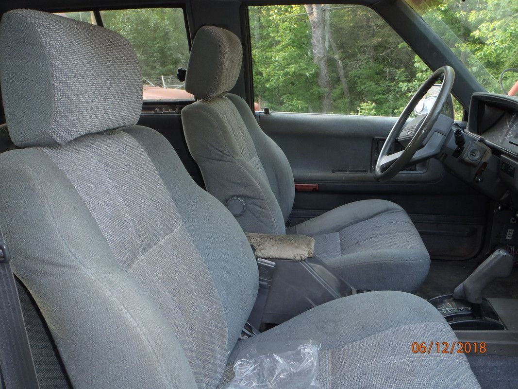

Originally Posted by arlindsay1992
Well the main reason is I simply didn't like it. I got good at taking the key out using the button even with just one hand, but it annoyed me. I've done it to three Toyotas and even a Ford Ranger that had a release lever to remove the key.
There is also a small practical benefit to disabling the button. When other people drive my truck, they will go to shut it off but not know the button is there. So they turn the key back until it stops (ACC position) and remove the key. Since the cylinder is worn out it is possible to remove the key from any position. This leaves the truck with the engine off but power being drawn by whatever accessories are on.
Anyone know what the button was originally for? I've only seen the button on manual transmission vehicles. And only on slightly older stuff, like early 90's and earlier.
i can confirm that the button is also present on automatic transmission 1st gen 4runners, as well as my ‘89 camry w/auto.
from my ‘88:
