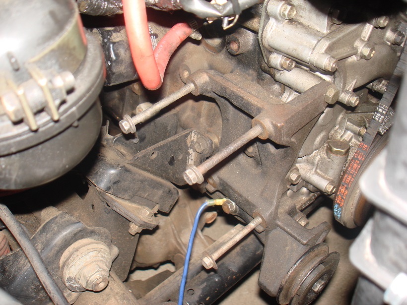

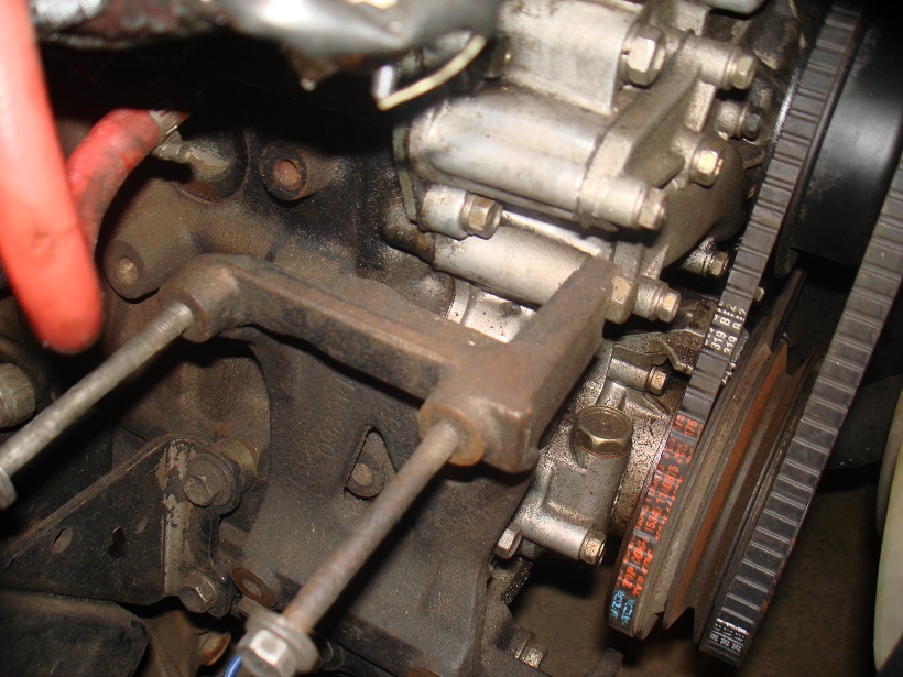

Hey guys, I meant "AC compressor bracket". I bought an 89 4runner last summer w 188k on it.... short story is pulled the motor (22RE) and had it rebuilt. Left some parts on it when I took it to the shop and picked it up with a bag extra bolts and a box of external parts? So now I'm playin "pin the part on the block". My question now is, do the AC compressor bracket bolts go through the timing chain cover on the left side? Any advice or pics would be awesome as well as make my life a lot easier. Thanks!

They absolutely do. I believe there are 3 bolts that go through bracket, through the timing cover, into the block on the front.

Sweet thanks! That's what I figured. Having some issues finding the correct bolts tho. The bolts the shop put in aren't long enough to grab sufficient threads in the block. Think I'm gonna have to go to the local hardware store and find the correct length bolts.

just happen to have mine pulled off. 93 pickup 22re
Bags of bolts are no bueno.
Good Luck!

Man those pics are definitely a life saver!!! Much appreciated! Hoping to get my rig on the road by the end of next week. Thanks again!
