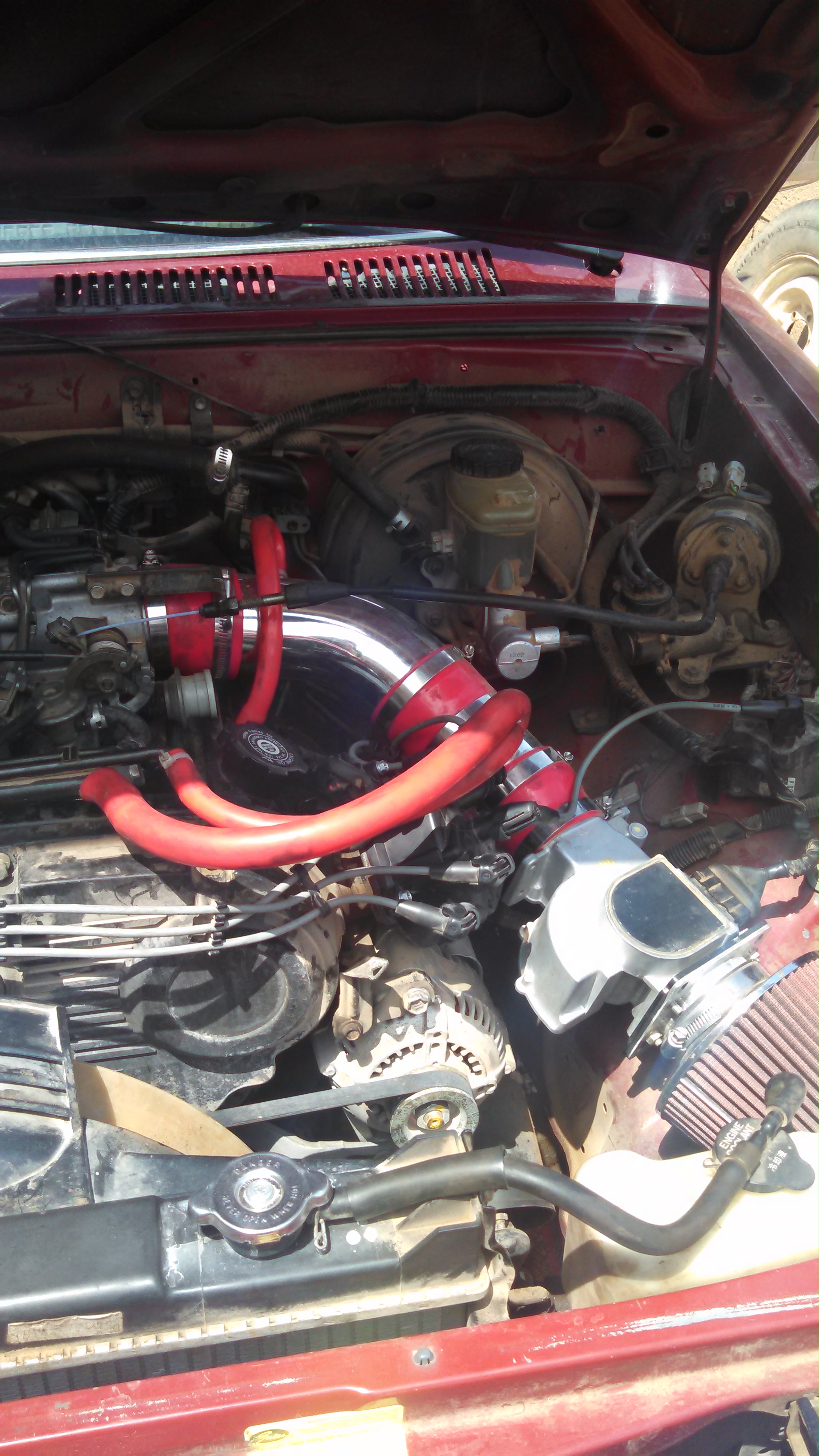

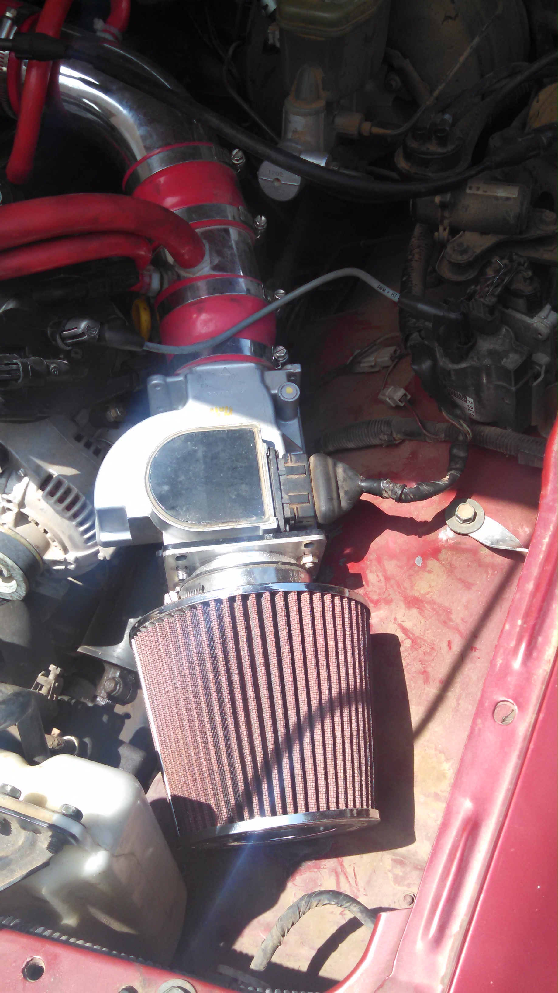

OK, no codes stored, it does happen. I still want pics of your intake, air filter and vacuum hose area.

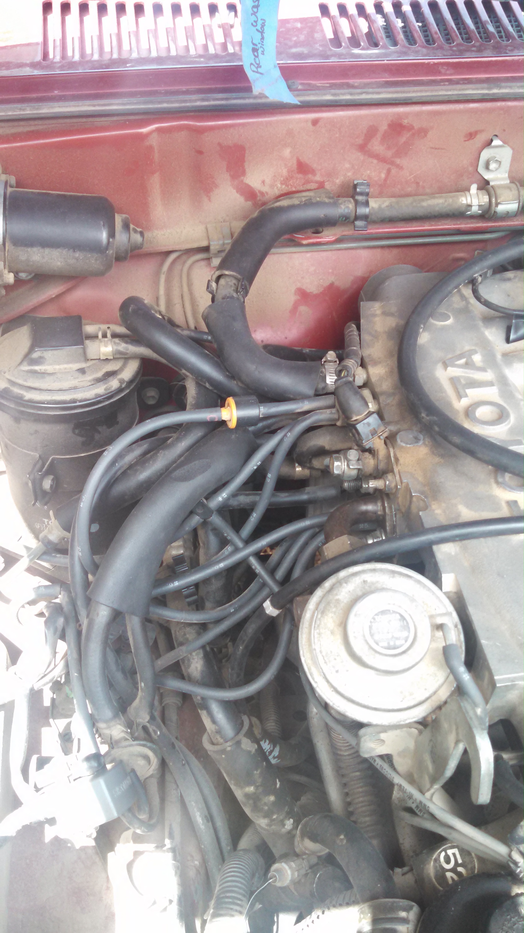

Old Jul 31, 2014 | 10:42 AM
Charecter1's Avatar
Joined: Jul 2014
Posts: 78
so heres some pictures of my vacuum lines and intake, they arent the greatest so just let me know if you need more.

^^^ what he said.
Check that the vac lines coming off the power steering are not broken, at the pump (its a plastic piece and over time can become brittle).
Also, confirm your vac hoses are all correct
