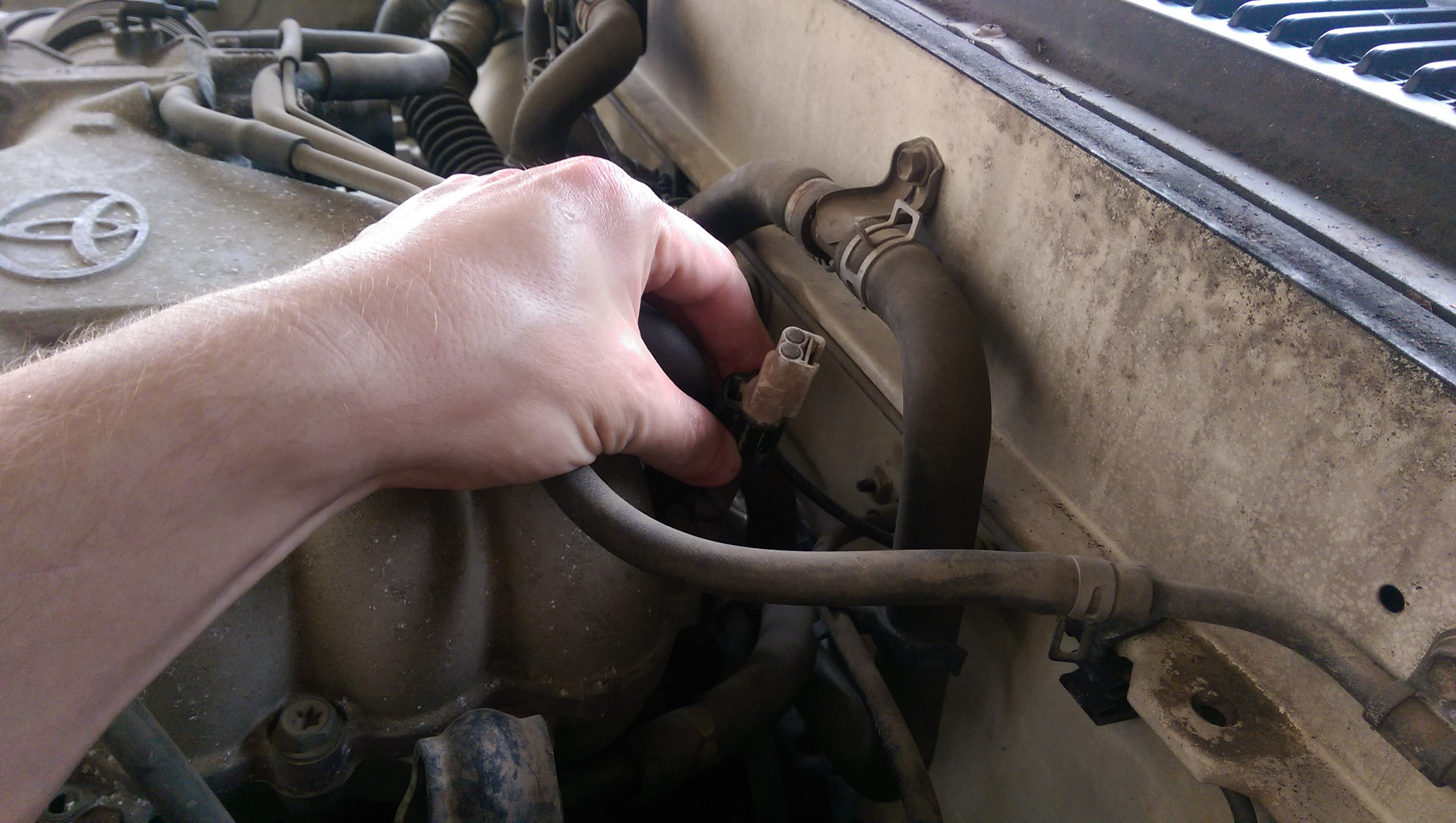

So tonight, I decided to give the vacuum hoses a better look. I started carefully following each of them and making sure there weren't any hidden ones that I missed on my first quick pass. That's when I found this dangling cable between the engine and the firewall.
It has very short play in the cable, so there's not a large area where it could go. However, I cannot find anywhere for this guy to plug into for the life of me. It's a tight fit behind there, and I'm not quite tall enough to lean all of the way back there and see everything between the engine and firewall, so maybe I'm not seeing something.
Does anyone know what this cable is and where it belongs? Could it be a source of my issues? O2 sensor? Or is it just a red herring?
More info about the cable - it looks like it joins into the cable cluster carrying the spark plug connections to the far passenger side and into the firewall.

The white piece looks to be some sort of plug. Is the check engine light on? Looking at the engine it looks to be a 3.4?
Since you already replaced the fuel pump and filter, look at the timing belt to see if it jumped time.

The intake air temp is apart of the MAF sensor. The plug you found may just be a blank plug, just guessing because the white piece plugs into it.
Have you tried resetting the ECU? Just disconnect the battery for a few minutes

I think you're right about it being a blank. So it was just a red herring.
