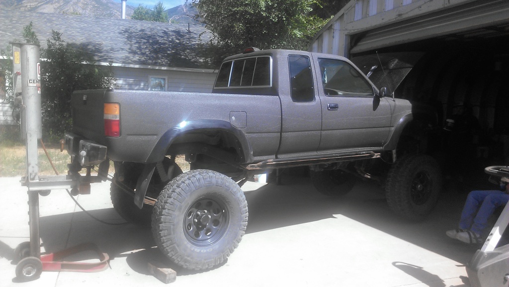

Old Aug 6, 2013 | 07:26 AM
  #140
highntight's Avatar
Joined: Mar 2012
Posts: 122
From: t town
took some poser picks with the air lift under the front and rear makes it huge just getting the tires barley off the ground. had to rotate tires and this is the easiest way.....
