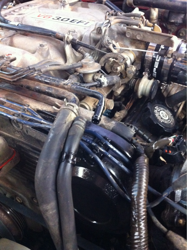

Is there supposed to be fuel coming from this hose with the line off?
Old 03-08-2015, 02:40 PM
bb224's Avatar
Join Date: Mar 2015
Posts: 8
Received 0 Likes on 0 Posts
That line seems to feed a reservoir under the afm and it's full of gas.

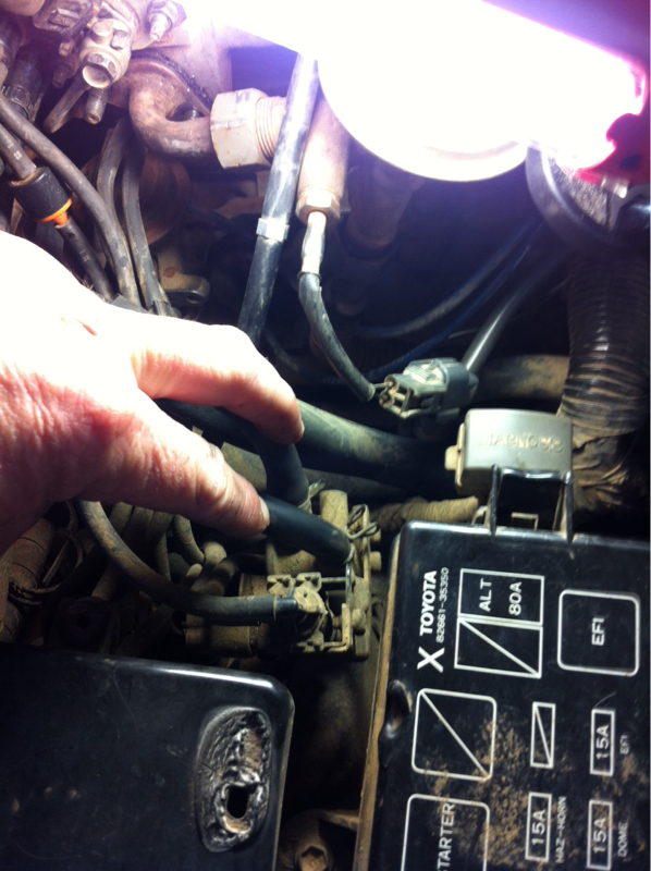

Is it possible that I got these two lines reversed?
Old 03-08-2015, 05:18 PM
bb224's Avatar
Join Date: Mar 2015
Posts: 8
Ok, so ive "hosed" it up pretty bad,(pun intended). I had one of the PS lines going to the fuel return!! Got that sorted, not sure how long the PS pump will last though. I need to know where the fuel return line and the AC idle up hoses go. Please Help

Got all the hoses back in the correct places! Whew! She blew smoke for about 10 minutes then cleared up. Anyone know what damage I might have caused? Have I ruined the PS pump?
Old 03-09-2015, 09:24 AM
Corey Barlow's Avatar
Join Date: Jun 2012
Posts: 165
Received 1 Like on 1 Post
Just flush it and add fresh fluid should good
