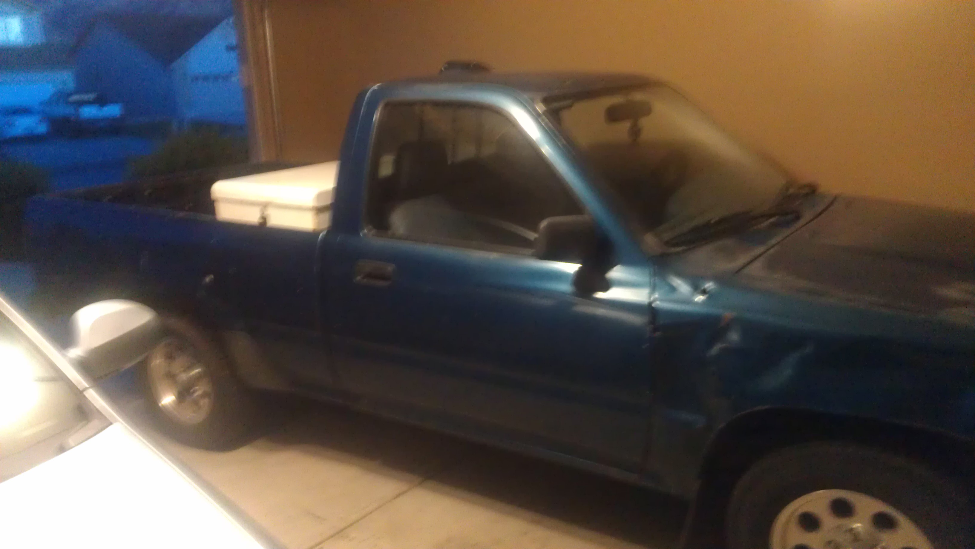

I have a 94 22re with the same problem!! I've also taken a stethoscope and cannot pin point the sound, but is definitely coming from the back of the motor. As posted above, on my motor the sound only appears after the motor has warmed up. I've had this truck for over 7 years and it runs awesome, still runs really good. But just started making the ticking sound last year, and it only shows itself between 2000 & 2200 rpm. I was terrified it was the timing chain buy I had my mechanic look at it and he suggested it was the flange gasket on the exhaust. So after hearing that I replaced the exhaust manifold and it did minimize it just a bit...haven't got around to replacing the flange gasket yet

***UPDATE***
I did in fact figure out what the infamous "tick" is!! Atleast on my 22re, the friggen EGR valve has a small crack in the line right before going into the valve!! What a relief, I've been sitting here thinking that I was going to snap my timing chain anytime.
