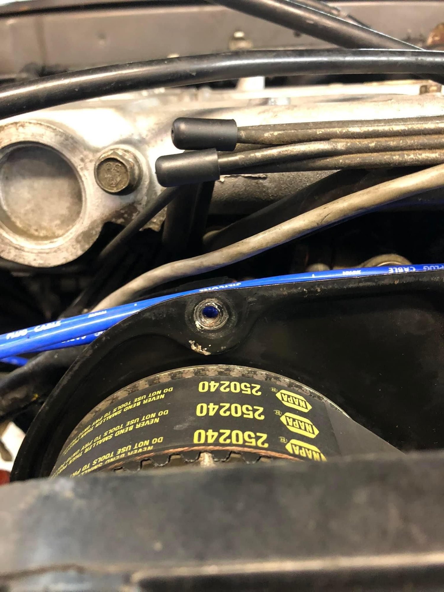

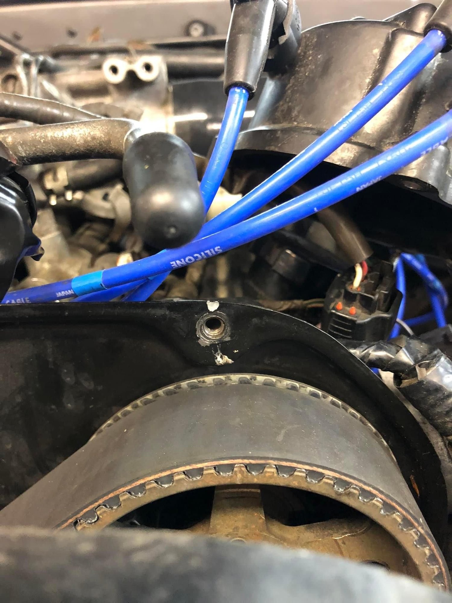

Thought it was timing and I rechecked the timing belt and everything is still lined up properly
