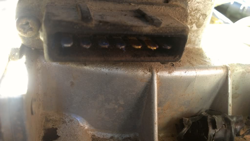

And does anyone know why there is no VC connector on airflow wiring harness? Yet there is a VC terminal on the airflow meter? Is this normal for V6 airflow meters or is this one fudged? I earlier thought that I accidently pushed the wiring into the harness but upon removing the boot there was no wire to be found....

My guess would be you are looking at the wrong FSM section (22re not the 3vze) and you have your plug upside down. look at the pictures in the book again not the two tabs at the top and three at the bottom, in this orientation the third pin from the left meter side(or right harness side) is NC(no connection) on the 3vze(v6).

As far as picture go..I have taken some to document progress on my HTC. As far as uploading them to this forum however...It is not as simple as I originally anticipated and have not yet mastered it. I know...I know....FNG right!
I believe that I was looking at the diagram for 22re and also was looking at it upside down. I was confused because there seemed to be a terminal connection on the AFM where it seemed it should connect to the wiring harness.
And here are the terminals on the AFM. Hence the reason I was confused

that connector in your hand is the afm connector.
