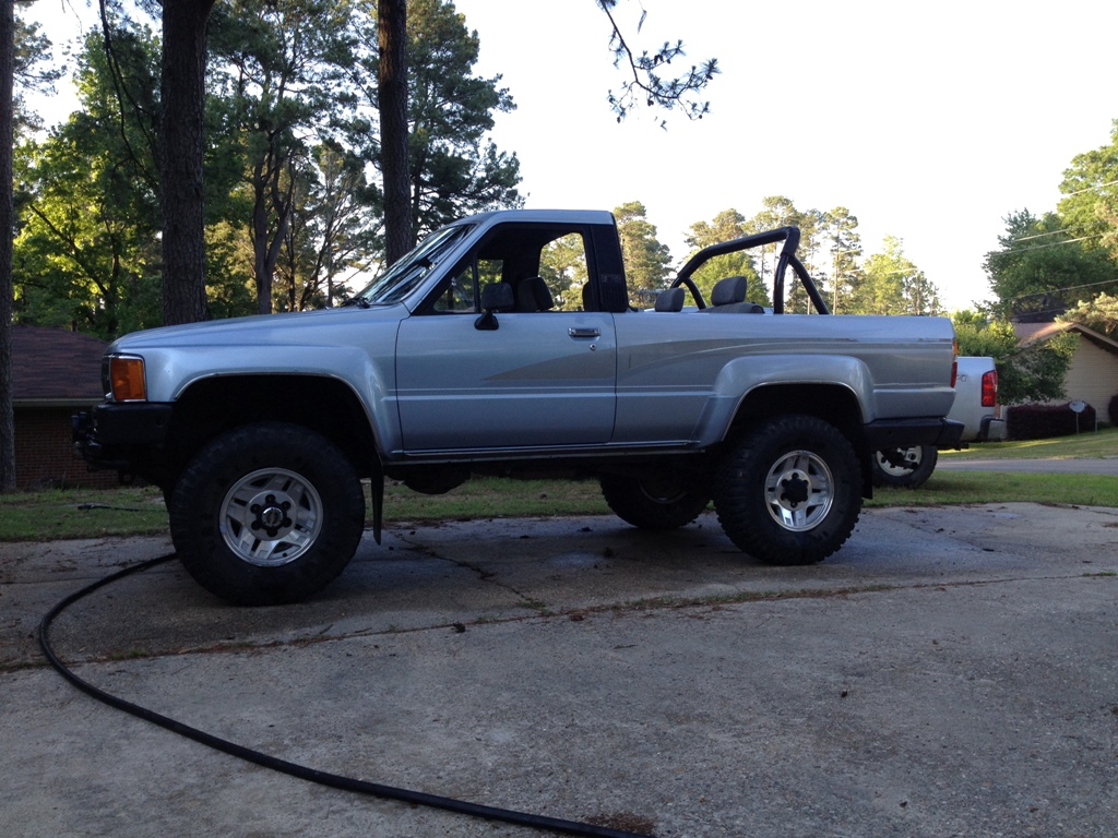

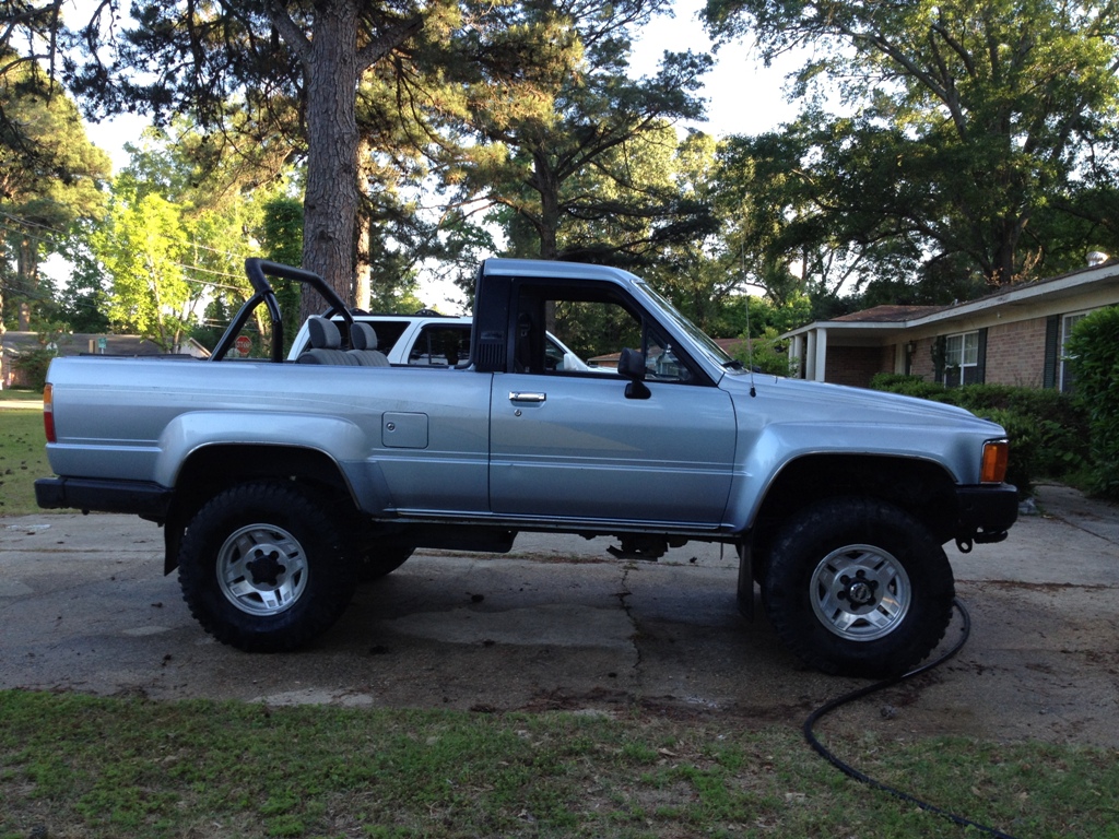

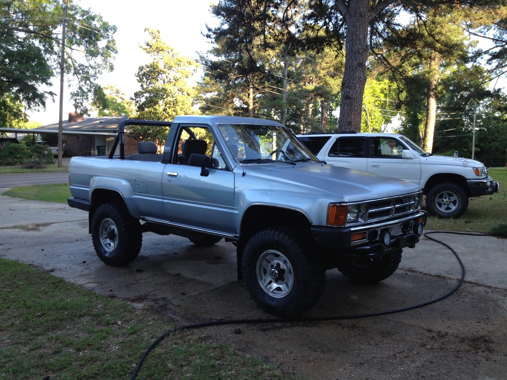

Hey, I bought this one for $300 on the way to the crusher. Fought an issue like yours for a few months and then got her going. I've put about $800 in it and now it's like my second kid to me. Deals are out there for someone like you who aint scared to get in there and figure out a no-run issue.
