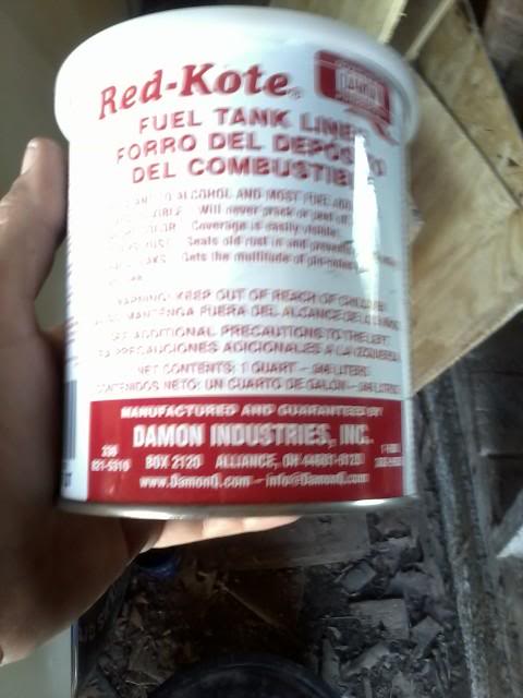

After I get my tanks clean, I coat mine with Red-Kote. It helps seals any leaks and it can be used to seal over the "rust" but I like mine to be clean as possible. You can get the coating at most parts stores, but they may need to order it.
