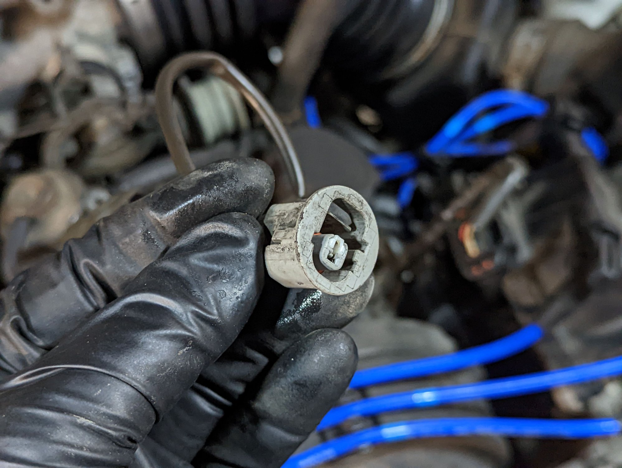

Howdy folks. Recently rebuilt the heads on my '93 3VZE automatic and I've got a mystery connector.
It comes out along side the distributor connector and seems like it wants to be somewhere in the back driver side quadrant. For the life of me I cannot tell where, even after extensive searching.
Any help is greatly appreciated!

Based on the wire color (Y-L) and connector shape: oil pressure sensor.
That sounds like a match! I'll check tomorrow and update the thread if it is. Thank you!

SOLVED! It was indeed the oil pressure sensor. Marking thread.
