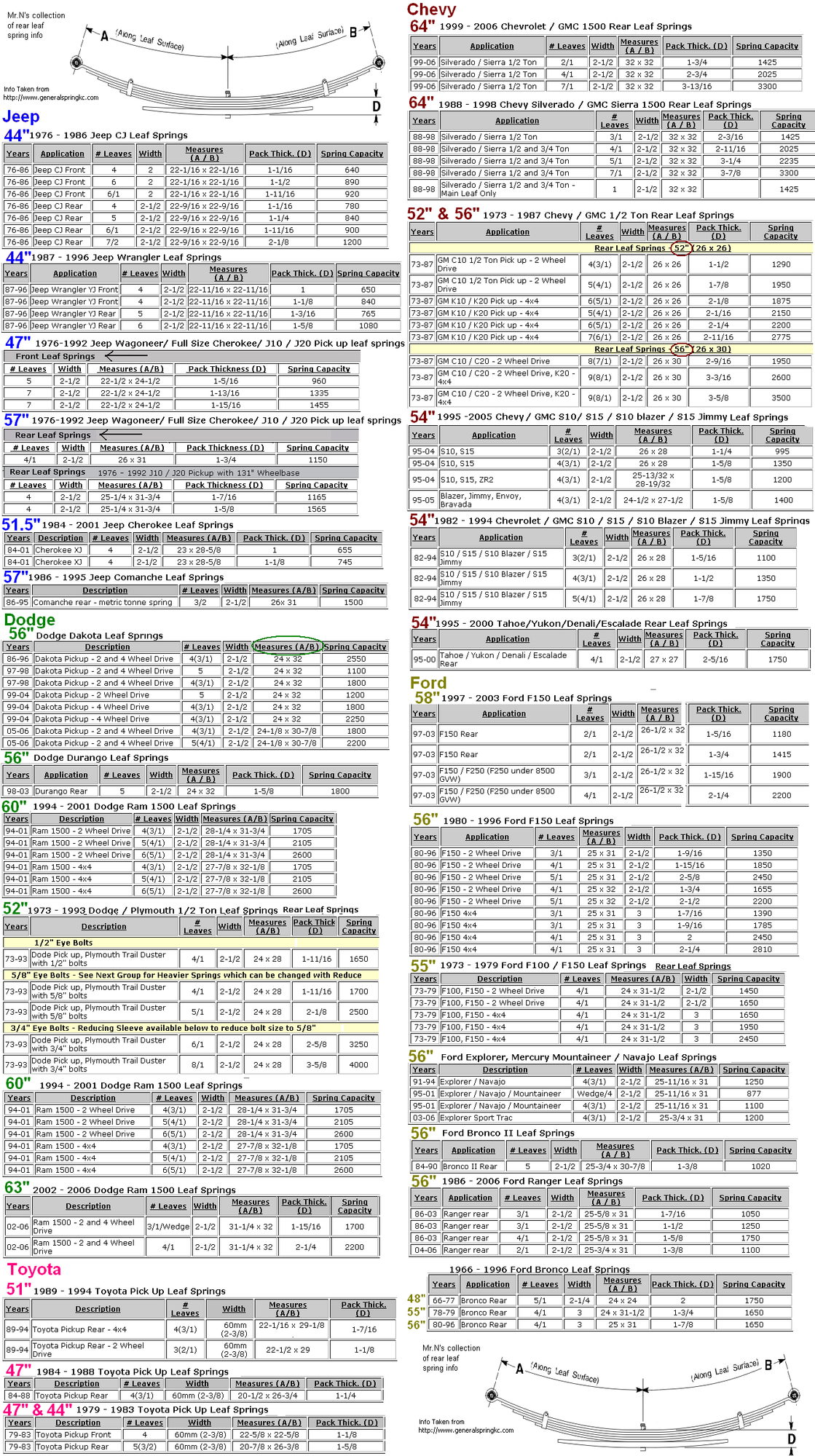

I just picked up a 93 2wd yota. engine and transmission are great, all is great except the springs. Don't know what was done to it, but one side has 3 leafs and one has 4 and a axle wrap helper. I would like to replace with new or good used stock springs, but have no idea what stock was.... Any help on source for springs and specs?

Thanks. rather have new but really wanting to know the factory spec. I am seeing 2 different stacks in the FSM. it does not specify which is the 2wd and 4wd.

3 leaf springs are found on the 2wd trucks, the 4 leaf springs are on the 4wd drive trucks. The springs are interchangeable just have to swap around the center spring pin. On the 2wd it points up and the 4wd it points down. This is due to 2wd springs mount on the under side of the axle and 4wd springs mount on top of the axle.

Received 45 Likes on 35 Posts
