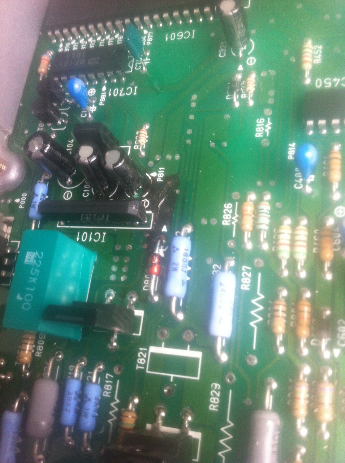

yea OSV, I've checked the fuel regulator before. But I killed power to fuel pump. To fight one prob at a time. Pump was wired to ign on by po for anyone catching up. I didn't think it should get pulse signal without distributor spinning either. Injectors 3&4 are randomly going to grnd with key on. I'm sure more than one issue with her but I want injectors stop opening like that first. Normally I'd crank it over to test injector harness with noids but this issue is key on injectors operating craziness. Thx guys I'm running out of ideas.
I took a pic of inside ecu, do u guys agree there's a scortch mark near center of pic above little red transistor? This truck was welded on a lot over the years. Could this be the weirdness? Maybe the welding machine fried the ecu? Asking a lot of y'all but I'm losing confidence here lol.

She's toast dude!
You need a new(used) ECU.
Remove the jimmy rigged wiring.
Check for melted or pinched wiring around the Intake manifold, Especially around the EGR Hot tubes.

you can tell if something is burned by sticking your nose next to the area, it will stink if it's burned.
you can also remove the board from the case, if it's burned the backside will probably also show some kind of damage... just be sure and ground yourself before handing the ecu, and try to touch it by the edges only.
the center cap out of that group of three capacitors looks like it might be leaking? can't tell for sure from the pic... when a cap goes bad it usually swells up, not really seeing that here.

Ive checked for a pinched wire and checked egr for melted wire...there's not anything like that. All looks good except ECM, I realize it's possible prob may not be the burnt computer but think I'll try that next since it's most obvious. The afm ohmmed out like it should seems to be good. Haven't found an exact match on ebay for ECM "89661-35830" I wonder if any other part numbers with three plugs and same pin count would be close enuf? U guys know?

Hey guys, got used ecm in today nov 12. That fixed her, she runs great no more overfueling. Thx for all your help.
