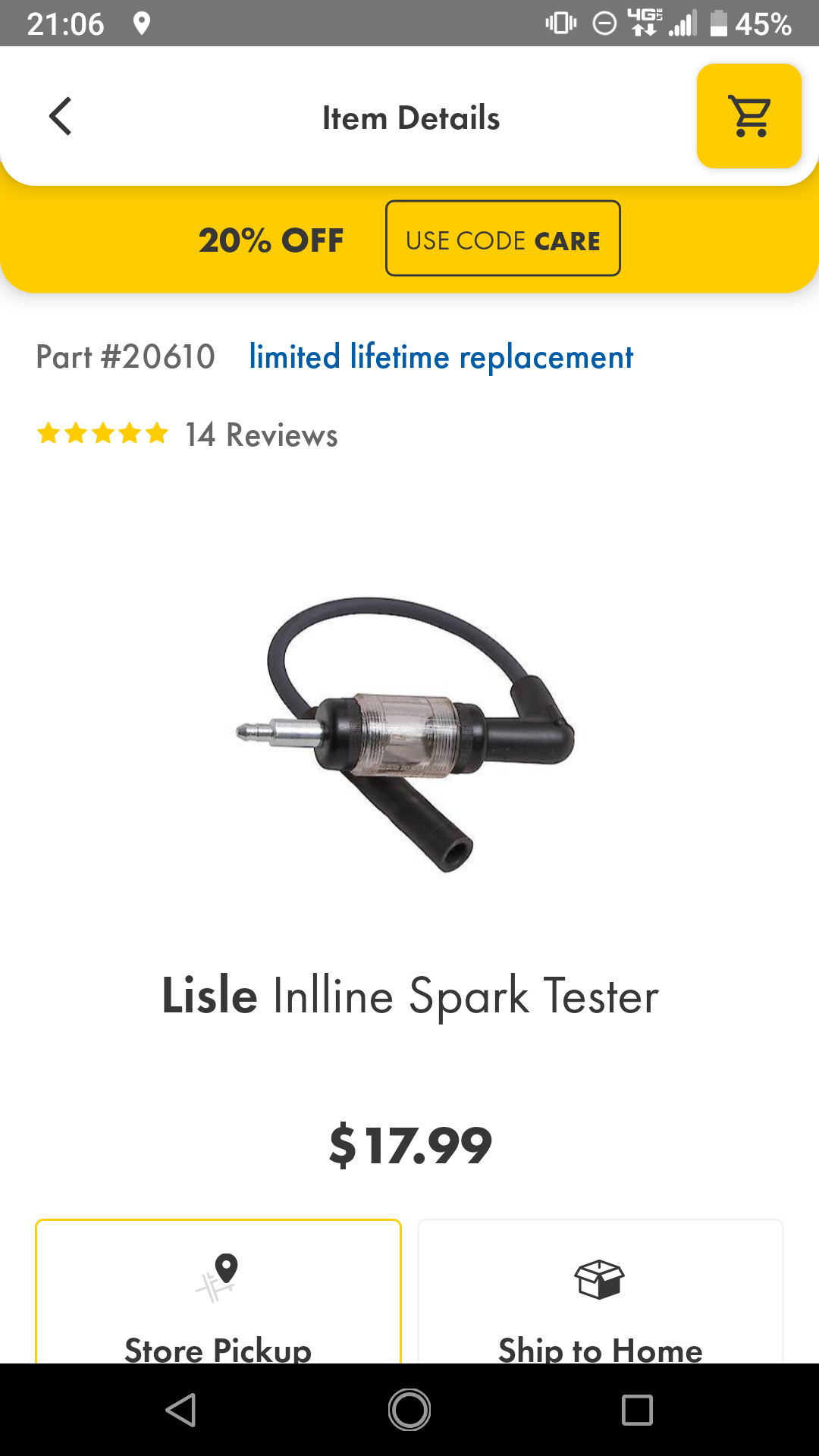

The best way to do this is with a spark tester. You can pick one up at any parts store for around $20.
This is my preferred style and the easiest to use (you can always YouTube "how to use an on-line spark tester"):
Hook this up in-line between each of the six wires. My money is on the coil. If the spark checks out ok, pull the plugs and inspect.

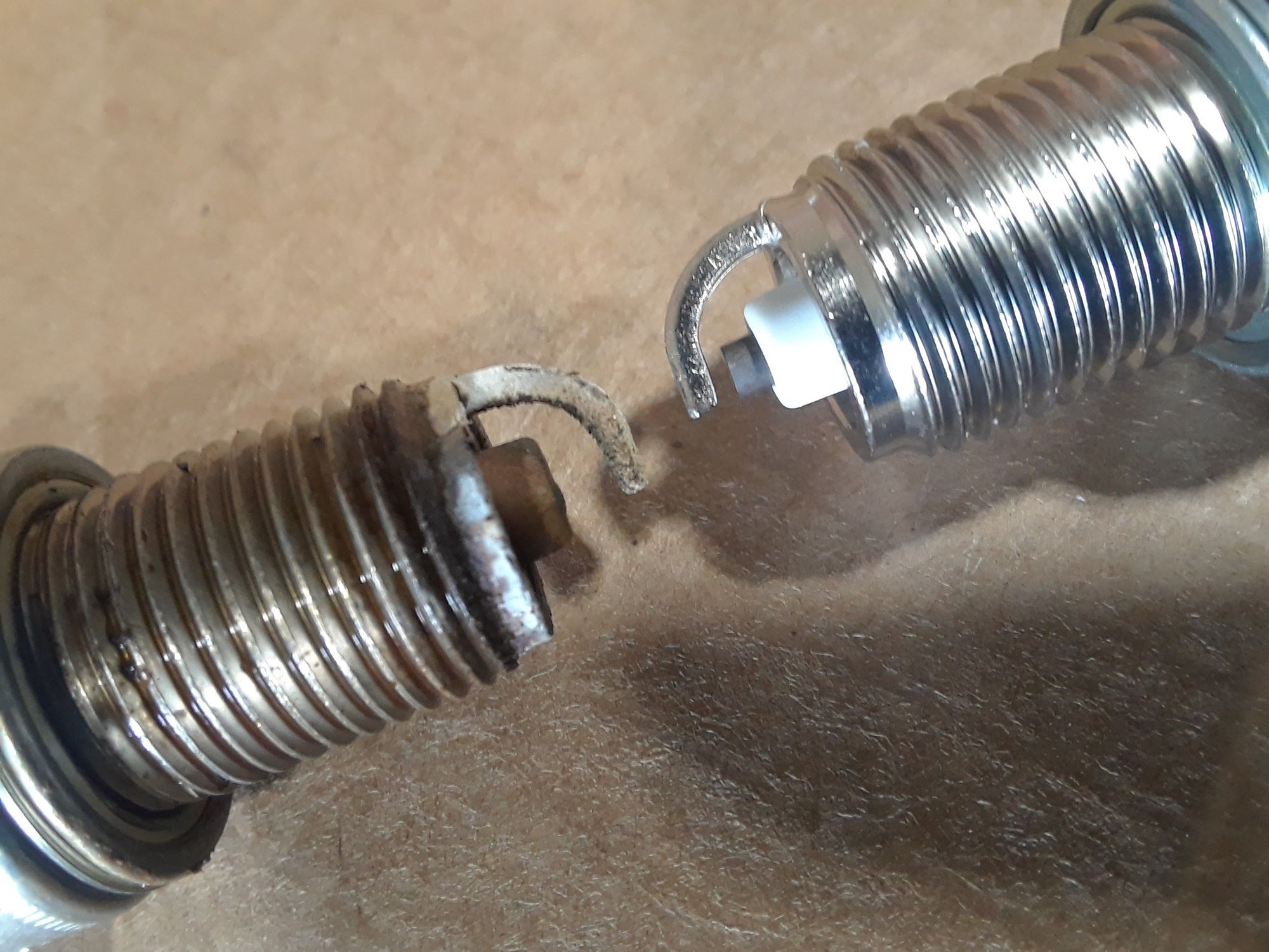

Here is a photo I took of a good plug vs. a bad one:
Notice the gap on the left plug due to the electrode worn away. This engine had very similar symptoms to what you are describing.
