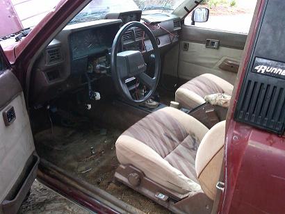

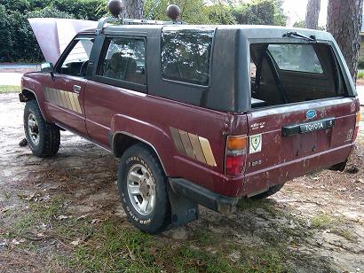

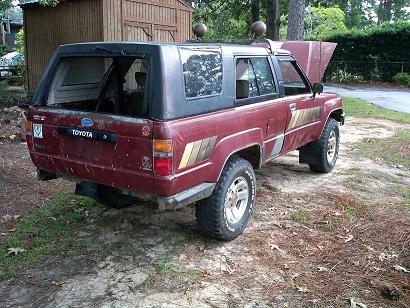

Pictures of the Runner
Here are a couple pics of the runner that I will be picking up this week. He has said 800bucks for the rig as it sits. 5days ago he blew a head gasket on the 22r.
What ya think? Sunroof has not been in it for couple years.
T_BONE

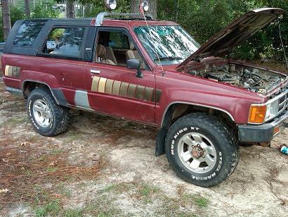

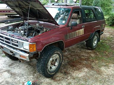

92 reg cab sas question-img-20110918-00323.jpg 92 reg cab sas question-img-20110918-00324.jpg 92 reg cab sas question-img-20110918-00325.jpg
Few more!
