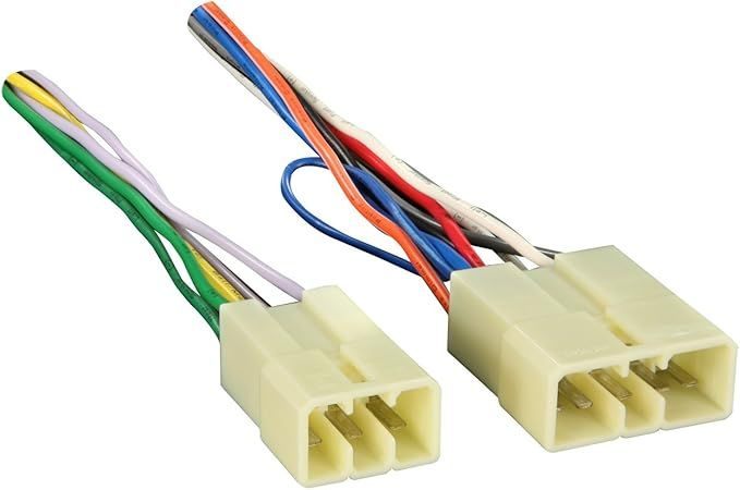

See if this helps.
I'd recommend getting a radio wiring repair kit. they're dirt cheap, under $10. Comes with the connectors and enough wire(usually) to repair the loom damage.
Then most decent radio companies offer an adapter that goes from their radio to your new connector. Very clean

Thanks for the reply! However, mine has the factory connector plug removed, so those harnesses won't help me in this case; I'm left to figure out wire colors. This chart is helpful though. Thanks again!

The wiring repair kit includes the same connector that came with the vehicle.
