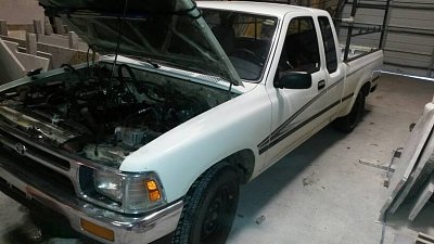

I recently acquired a 1992 Pickup ext cab 5spd with the 22RE. I was to perform and head gasket job for someone. After finding other issues the owner decided he didnt want to spend the money, so he signed the title over to me for my labor, about 4 hrs.
Now that i got the story out of the way. I discovered a missing timing chain guide, very slack chain, damaged timing cover, and oil pump. I did drive this thing 3 miles to my shop without a problem, which surprised me. I already have the top end mostly apart, I have a head gasket set, timing chain kit, water pump, timing cover, oil pump, and i just placed a order for upgraded 4 hole injectors.
Is there anything else i should plan on while i got it all apart? I would also like to here what yalls spark plug recommendations are. The truck does have 616k miles on it but the motor supposedly has around 200-250k and is from a 93 model. The truck is in excellent shape though for the mileage. No rattles or squeaks.
now onto the pics...
I will be updating this thread as it progresses. I plan to use it as my DD. It has to get better fuel mileage than my other trucks.
