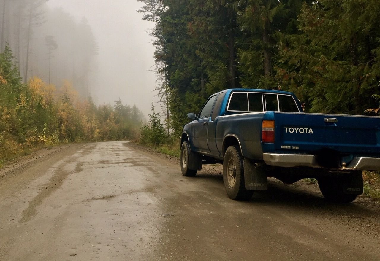

I recently bought a 92 pickup SR5 with 300 000km and have an issue that I'm having a bit of trouble tracking down. I'm use to front wheel drive cars, so it could be something pretty obvious, but it seems like a wheel bearing to me. Occasionally ill get a slight vibration that almost sounds like i'm driving over a very small rumble strip in the road. It seems to be coming from the front drivers side, but its hard to tell. It isn't tied to any particular speed or gear though does seem to be more noticeable between 40-70 kilometers an hour, but i assume that's because it becomes harder to hear once I'm up to speed. it will pop up randomly and last between half a second and maybe 3 seconds before going away. Taking my foot off the gas usually gets rid of it, along with bumps on the road. It does seem to be worse when it's cold outside, and will only happen about half the time that I take the truck out. It does seem to be worse within the first five minutes of driving.
The wheel seems tight, without any obvious play and the front end doesn't really have any other strange noises while driving. Thanks for any suggestions. I don't know how to make the picture any smaller, so enjoy!

Hard to tell from your pic if truck has ADD system or manual hubs. If ADD first thing to cross my mind would be dry steering knuckle bushings.
