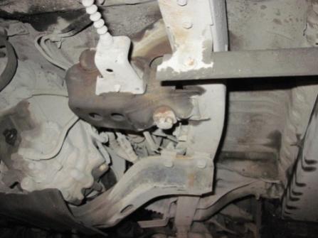

Can anyone provide a pic of what the nuts and bolt look like at this torsion bar? Possibly a before and after pic.
this is what mine looks like, its on the inside of the frame but i have a 91 toyota.
that was taken from a rear looking front angle.

OK I have located this part, but do I need to hold to nut at the top while I turn the bottum with the ratchet or should I loosen the nuts then turn? Which way do I need to turn this bolt to raise this side of the truck?

righty tighty lefty loosey...
tighter will raise it, looser will lower it..
i put a big pipe wrench on the bolts..
i couldn't get the locking bolt loose so i just muscled both of them tighter.

I just tightened on the bottom one caue i could get to it, and it worked so you dont need to hold the top one. Just tighten the side that leans to raise it.

Well, mine wasn't seized to the bracket that holds it on so i actually had to hold it :/
you should have checked to see if they actually just tightened one side, because you probably could have lowered the too-high side, too.

Those adjusting bolts can break. Tightening the nut side is way easier on that bolt AND you don't have to hold anything.
You will need to have it aligned after you adjust the height.
