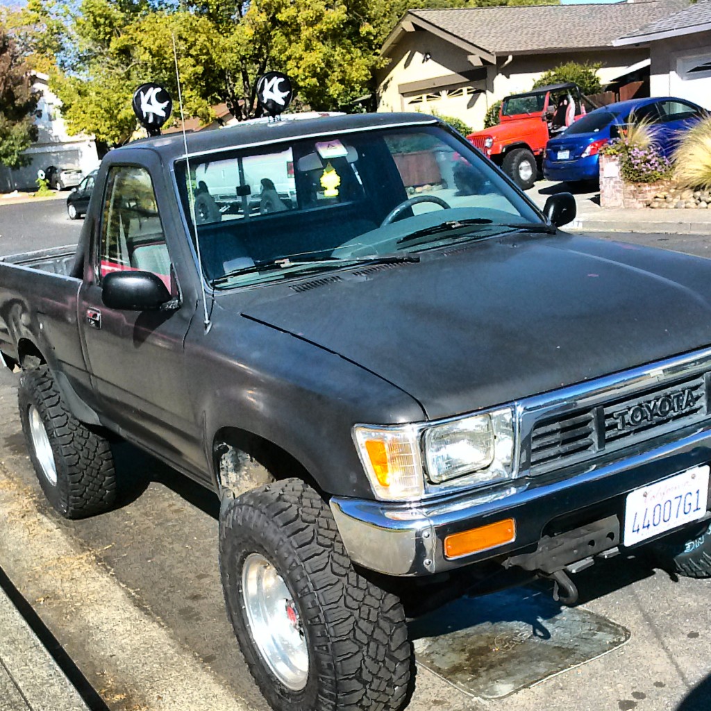

Here is the pic of the truck that I purchased. What do you think ?

Looks good! Body looks to be in good condition and the tires are nice. Does it have a lift? How about a picture of the engine?

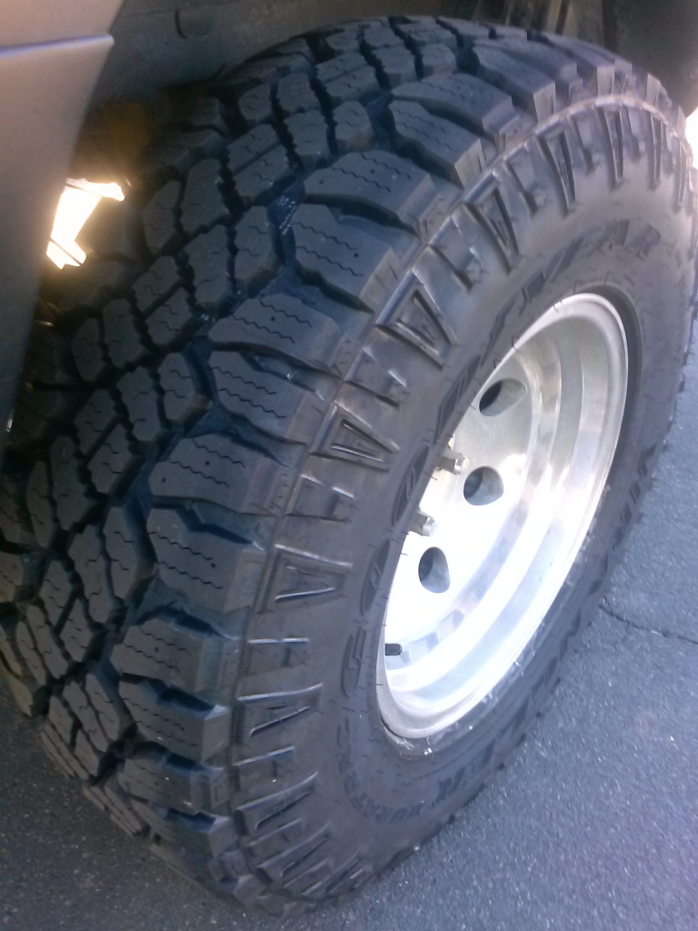

the tires are 31's
Got the tires brand new for about 900 through Americas tires company. Great tire but sometimes kicks up huge rocks and scares the ˟˟˟˟ out of me lol.

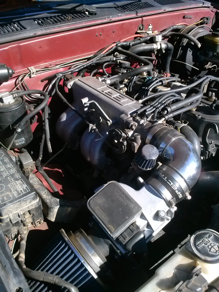

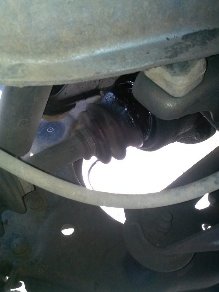

Pictures of my engine and torn boot
Tomorrow I will be attempting to flush the heater core and change the resistor. So I can get all my settings back with hot air, not just blowing on high with cold air. Also I watched this video on surging idles and i'm going to give it a shot..
I really need to fix my cv axles but am nervous to try.

Thats pretty sweet that the PO already swapped the intake and battery for you.
