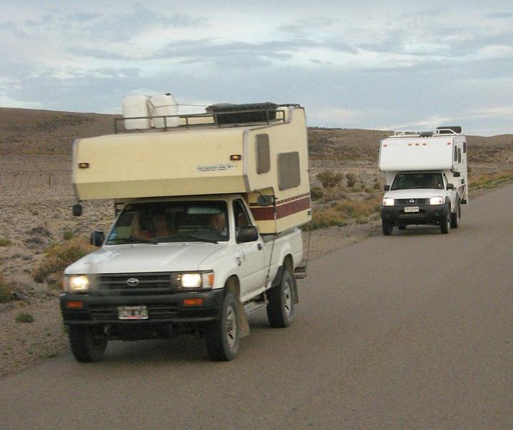

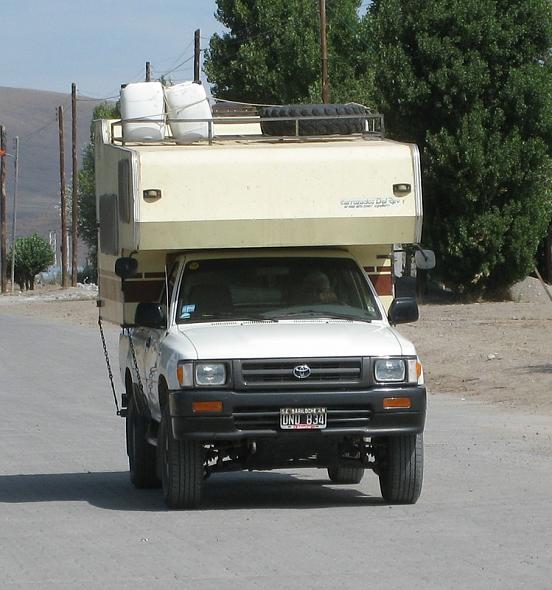

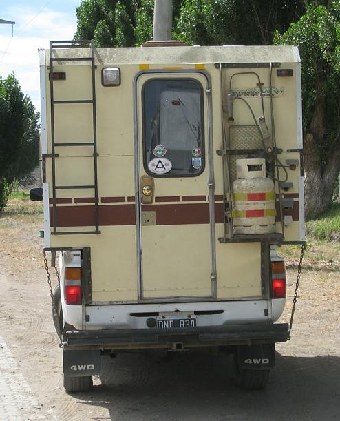

this would be really cool

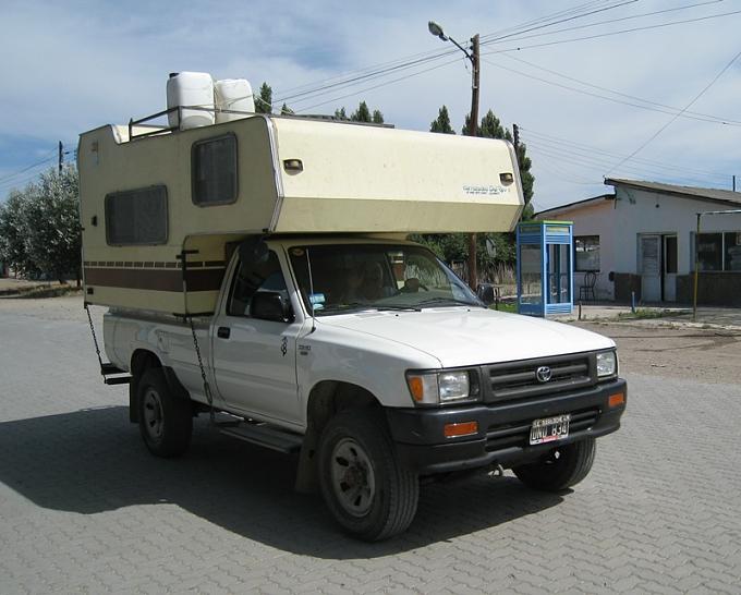

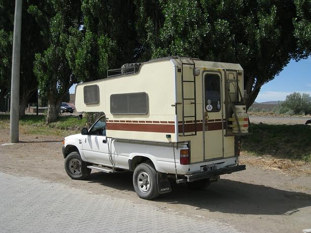

Attached Thumbnails 91 Long Bed Suspension Upgrade/Custom Camper Top?-yota-camper4.jpg   91 Long Bed Suspension Upgrade/Custom Camper Top?-yotacamper-3.jpg

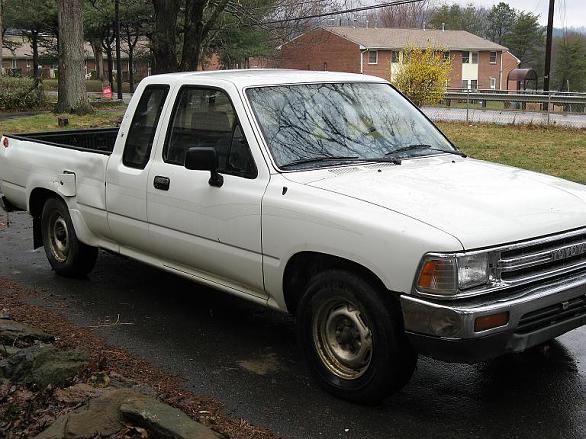

I do have a picture, I hope it shows here OK. Yesterday I replaced the shocks. I got Monroe Matic Plus on the front and Monroe Sensa Trac on the rear. The leaf springs are still bottomed out though, and I figure that since the previous owner let the shocks get real worn out, it put extra stress on the leaf springs and now they are all sagged. I'm not sure, but I think the helper coil spring might be the best and most cost-effective way to get some lift on the rear and take pressure off the axle. I hope to have all this done pretty soon, and if I can scrounge up a camera, I'll post some pics.

That looks like a short bed (6 foot) to me, but it's hard to tell from that angle. Interestingly, a long bed '91 showed up on my local Craigslist yesterday:

x2 that is a short bed. i dont think they ever made a long bed ext. cab.

Short bed it is
