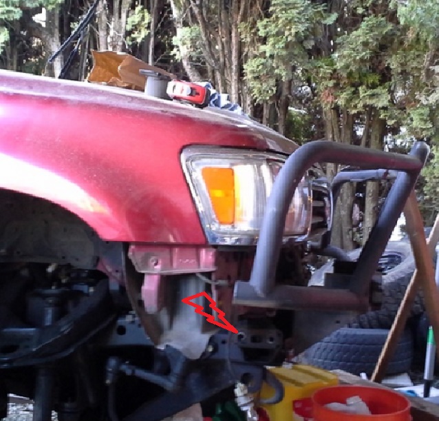

M12-1.25 X 50mm Hx Hd Cap Screws Fine Thread CL10.9
if you mean the bottom bolts that are circled, I wasn't able to find them local. Had to order them on Amazon

if you mean the two mounted on the frame, not sure what size. I would be able to check in a couple of days. I would recommend tying your winch mount into the 4 on the front and the two on each side

Here is a pic of the already tapped holes i want to use.

Those are exactly what I needed I already picked them up at a local hardware store. Thanks for the help
