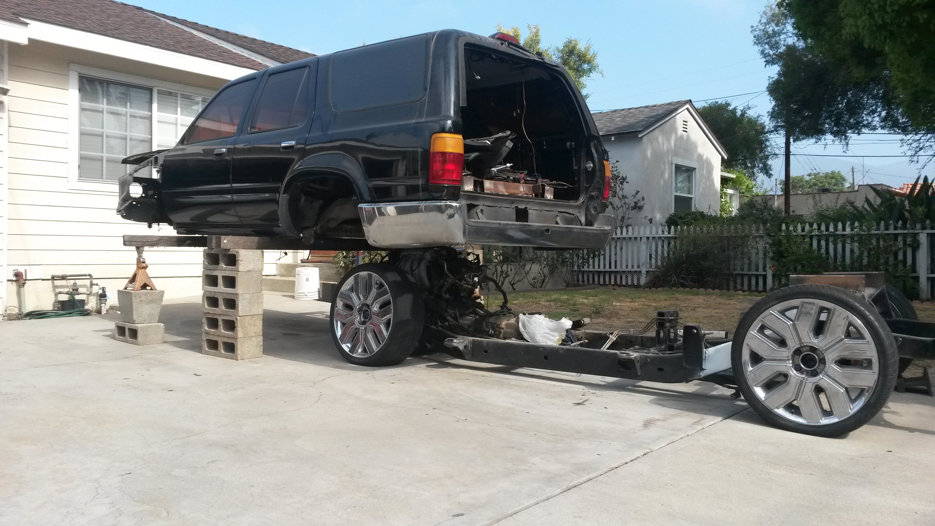

Im building a 91 4runner bagged and bodydropped. My rear axle is about two inches to wide for the 4runner body to fit all the way to the floor.the rear axle is from a 96 tacoma. anybody know of a different year i can swap thats two inches shorter while keeping the 5 lug bolt pattern

sure 79-95 2WD truck axle, 56" WMS to WMS
if that is too narrow look at Mazda or Ford rear axles
be careful using cinder blocks, they tend to crush and fall apart at the wrong time
