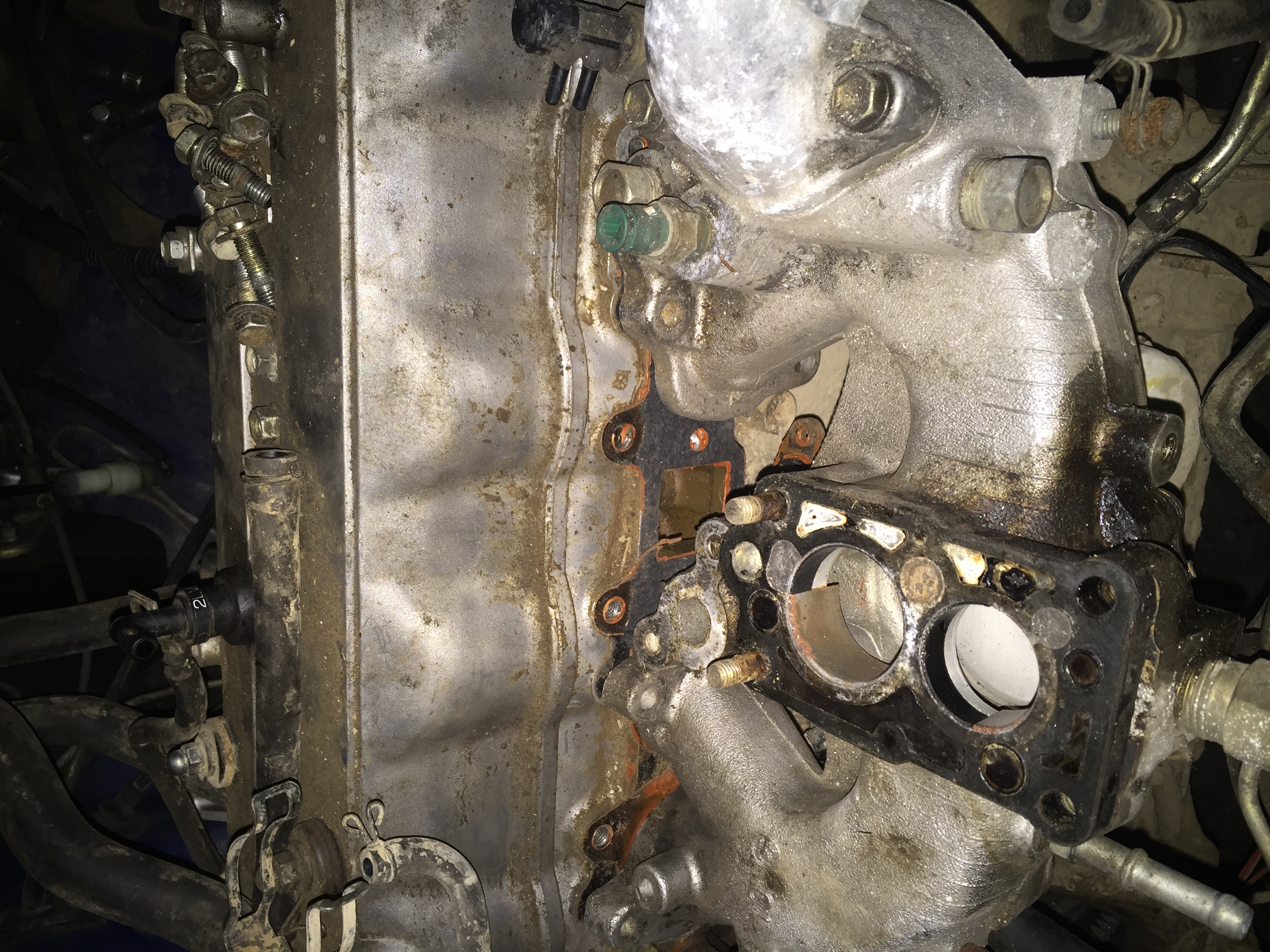

i picked up an 86 Toyota pickup that originally had 22r in it and previous owner dropped in a 22re so I'm just trying to convert it back to carb'd since he didn't keep the body wiring harness. What all do I need to do besides get a late model 22r intake manifold? All help is appreciated

Got an intake manifold with the pear shaped ports but there is one it doesn't cover did I get the wrong one?

See the attached picture

There is a square metal piece that goes over it. You are missing a piece. Just taking a quick look and what I can see everything looks good. Try going thru my 85 thread in the link below and on the last few pages and you might see what I am talking about. Kawazx636 has his blocked off https://www.yotatech.com/forums/f114...torial-264405/ and may show some information.
