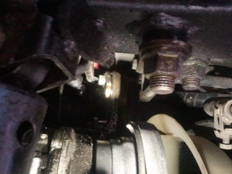

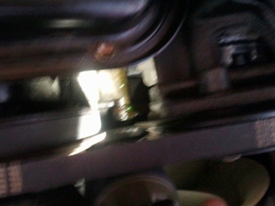

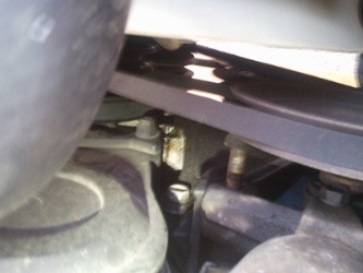

So about a week ago i discovered a large puddle of oil and coolant. Originally i thought the oil pan was leaking from how the oil was dripping from there. But as i got to cleaning up i tightend the oil pan bolts and put oil in and it slowed the leak down but it is still leaking somewhere above the pan. I tried to get some pictures to help.
Pictures are bad but...
in the center you can see anti freeze.
from bottom
in the center you can barely see a drop of oil.. its hard to see because its shiny from the flash light
from bottom
in the center there is anti freeze.
from top

Clean off the grease/grime and then look carefully for the source. Could be the water pump, a hose, crank or cam seals for oil....several options.

Well I went to O'reilly's and picked up some degreaser and a mirror on a telescopic handle. Got everything as clean as I could and started looking with the mirror... since I had to drive from the car wash I was kind of hard to see exactly where the oil and everything was coming from but I used some towels to clean the new stuff off the best I could then I started my truck and let it run while I looked around after about 2 minutes oil started really dripping and I shut off my truck and used the mirror by the timing belt and found that for sure the oil is coming from what I believe is the oil pump... it is leaking from it directly above the oil pan and pooling there like NickMiller said. So can anyone reassure me that it is the oil pump? As for the coolant leak I found that by pure luck, when I was laying on my back looking up as it was running I spotted a little shiny green drop coming from the top of the engine across from the top of the fan. I think this is the thermostat? So now I have to find a way to get the oil pump out and replace the seal I’m assuming and seal the thermostat. So that is where I am at now.

Tdub8, the oil pump does not need to come out to replace the seal. It often replaced when the timing belt is done.
That upper water outlet is a known leak point. There is FIPG/RTV that makes the seal and when it goes....leak, leak.

BTW i fixed the water outlet leak... Only needed to be resealed.

Well went home for thanks giving. Drove my truck and stopped every hour or so to check the oil and didn't leak as much as i had expected it would. Any way my dad and i replaced the main oil seal and the leak is gone! We had discovered that the oil had been getting carried up and thrown around by the timing belt. Luckly for me the total project cost about 6 bucks and around 3 hours of work haha.
