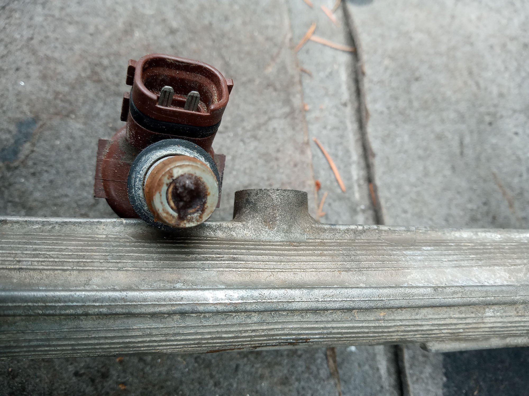

Finally narrowed it down to clogged injectors. Ordered new ones then pulled them today and sure enough!! 3 were extremely clogged

Very good I was about to suggest injectors since the misfires were not all on the same bank. That's one dirty squirter there.
