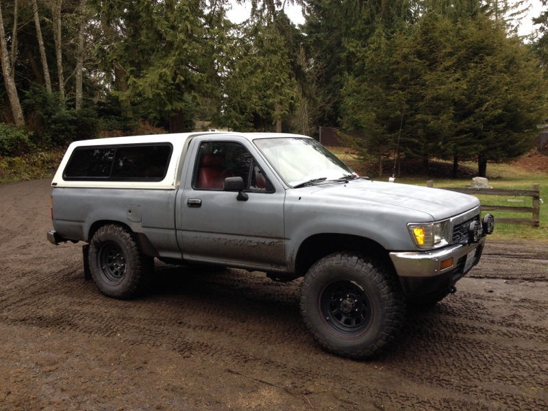

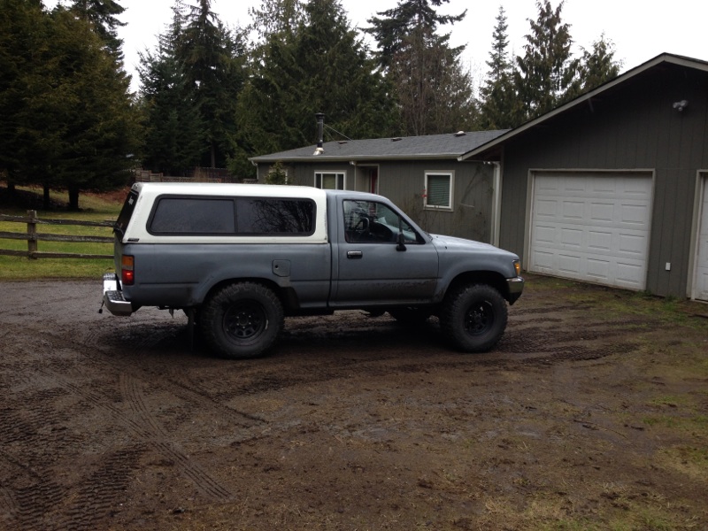

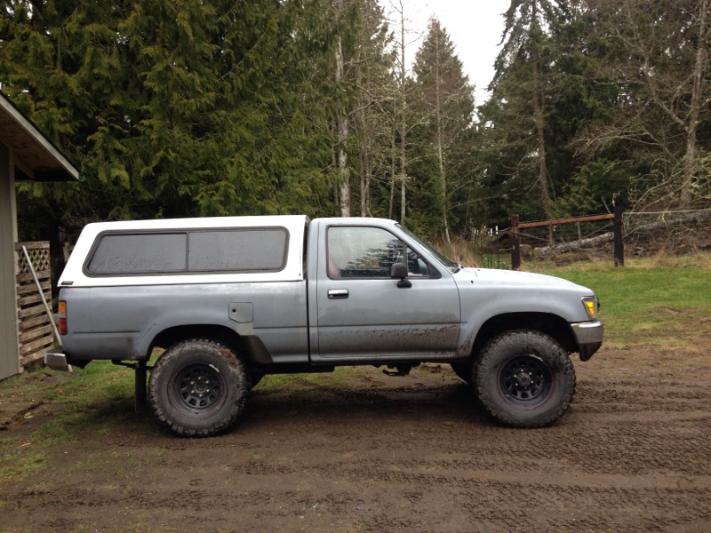

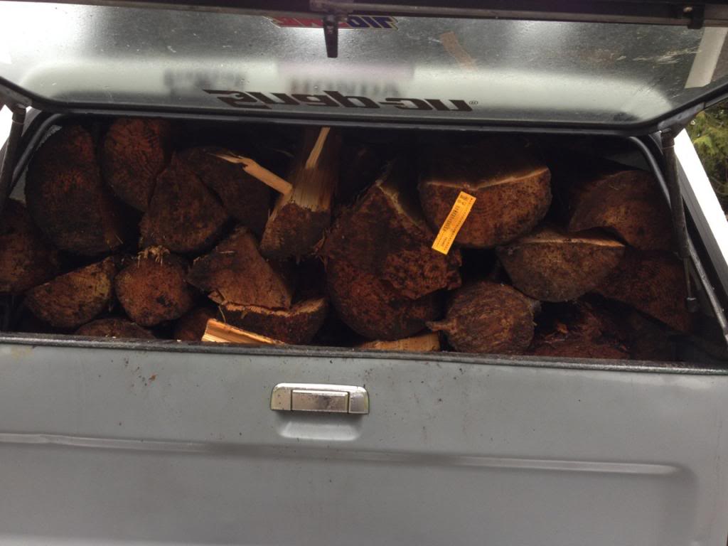

I have a 89 Toyota pickup that i have been hauling wood in for a while now and it puts lots of stress on the rear springs obviously and Id like to see if anyone has ran air bags .
Im looking at a set of Firestone Ride-rite bags and id like to see pictures and pros and cons of people who are using these or another brand of air ride bags
The first three pictures are loaded with wet wood to the top of the canopy
