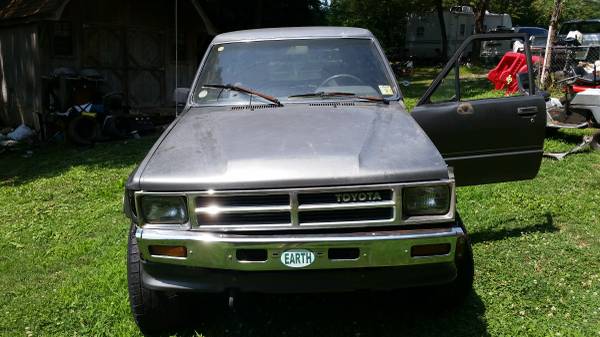

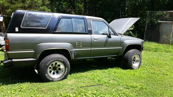

Hello everybody. Just got my first Yota. Always had (and still have) lifted Cherokees, but decided I wanted something different. So I bought myself a 89 4 Runner. The first gen.
Since I bought it yesterday, ive found a few problems.

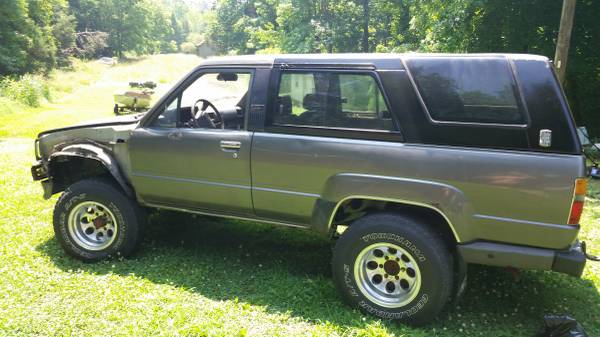

The drivers side front tire seems like its been pushed back. The passenger is where it should be from the factory, distance from the fender to tire/bumper to tire, but the drivers is pushed back into the fender area. I didnt notice it until I loaded it onto my trailer and saw it. Nothing looks wrong visually but something definitely is. Im going to get it aligned and hope it drives alright. Wheels are toe-ed out really bad.
Sounds like it has a misfire. Will idle by itself after it gets going but It has no power, and runs like complete crap. Had to have it in low to get it on the trailer. (I found one of those foul prevention things on the #2, and only #2 spark plug. Took it off. Havent started it since yet.)
And now it doesnt want to start at all. Lights stay on but all I get is a click. Tapped starter. Nothing happened. Its probably just bad.
Other than those few (big) issues, I got to compression test the #1 cylinder before the starter went out and it read 150.
Rust free frame and body
Transmission shifts great, and ESPECIALLY the Tcase. Best shifting TC ive ever had.
Tires are good. Mickey thompson rims.
Anyone have any input on my new Yota? Paid $1300 (too much, but need a new vehicle)
Pics are from the ad. Will get more tomarrow. I have the fender, its just off in the pics.

Why was the fender off??
If it took a hit on the left front perhaps something has been pushed back..
If that is the case a front end alignment might be real interesting.
Did you pay to much time will tell.
Shame on you for not looking closer no doubt when you saw this you could not say no.
This happens at times with first time Toyota buyers.
You don`t say what engine .
I bet you have a bad ground condition check that before putting another starter in.

Supposedly because it was beat up and rusty. its a little dented but not got-hit-by-a-car or anything dented. Just bent a little.
I looked over it as good as I could but until I could see it on the trailer, parallel to the front I couldnt tell.
It has a 22RE. Engine looks nice and clean. dont count for much if it runs like ˟˟˟˟ though.
Im going to go through and check all the wiring on this thing tomarrow.
I kind of wonder if the PO drove it into a ditch or something, and thats why the fender is decent but the tire is pushed back. He also put on new tie rod ends (which is partially why its crazy out of alignment)
