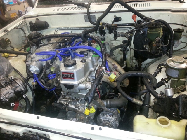

This is my first post here at YotaTech! I just got my first Toyota (88 Pickup, New 22RE with about 10k miles, bored out, Marlin Crawler Clutch, 2.5 inch exhaust with masterflow muffler, 170 amp alternator, pro comp leafs in the back, big bore throttle body, brand new rotors/calipers/pads, and same other adds). This is my first Toyota, and I am very happy to finally be apart of the Toyota family!
When I first got it, it was running like crap. It was acting like it was just running on three cylinders. We thought it might be a bad head or cam, but turns out that it was a muuuuch easier and cheaper fix. It was just a clogged fuel injector. Replaced the injectors, and it now runs like a dream!
Anyway, the reason I am making this post is because it is not leveled out. It has the nose bleed going on (shown in the picture), and I would really like it to sit level. Someone mentioned to me that I can just get 2" spacers for the front and it should do the trick. Does anyone recommend this? Maybe some other suggestions? Any input would be appreciated, thank you!
