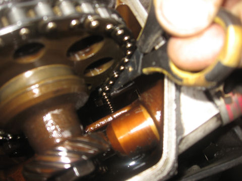

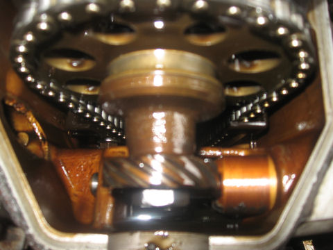

So I took the valve cover off today and set the valves, new tappet gaskets (valves weren't that far off).
I inspected the timing chain. Cranked the engine clockwise to TDC and chain is tight (both sides). I can crank counter clockwise and slack the drivers side (passenger side tight). The chain guard is there and intact but it looks like just plastic inside. Time for a change? Is it feasible to wait for summer?
I plan on getting a compression tester sometime this week..

The stock guide is plastic, well a phenolic... nevermind.
But fortunately, it looks like the guide is still there. That doesn't mean things aren't worn and need replaced though.
I'm also going to venture out and say that both 15w and 20w weight oils are sufficient down to 0C/32F. So maybe you've just got a little bit of bottom end wear (rod bearings) and 10w is just a bit too thin. Mine sounds like someone tapping as fast as they can with a screwdriver on a tin can for about 2-3 seconds if I use 10W oil, even with a warm start, but is only a "tap tap" with 15w and never makes a noise with 20w.
