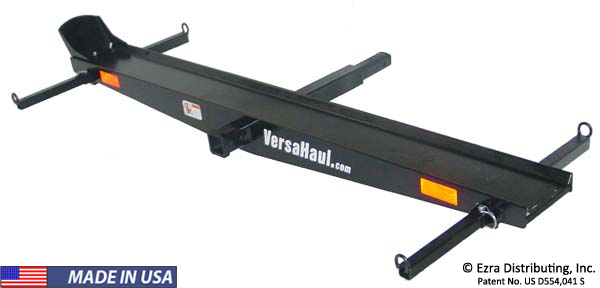

I want to transport my old Honda NX650, mountain bike, and road bike.
I'm thinking of buying the VersaHaul Sport Motorcycle carrier which has a max load of 600lbs. Then, plug a hitch mounted bicycle hauler into it.
Everything together weighs about 518 lbs
90 - hauler
340 - motorcycle (dry)
35 - mountain bike
23 - road bike
30 - bike hauler
I could take the wheels of the bikes to reduce that a little bit.
Going to haul a spare tire/wheel, computers, clothes, bed frame, tv, camping gear.
I can try put the spare and any other heavy items right behind the front seat to distribute the load.
Is this doable?

More importantly what type of hitch do u have class v? It is 500 pound 'tongue' capacity
you really need to inspect it and mainly the bolts condition. Is any missing or rusted to crap? If so replace with atleast grade 8.8 or better yet 10.9 grade bolts and you should be fine. They factor in a safety margin but if it's all rusted I wouldn't trust even standing on it- speaking of which why not get a few buddies to stand on it like 600 pounds worth and see how it looks.
Check out some trailers on CL can find them pretty cheap then sell it when u get to Cali... Less stress on the 4Runner (and you!)

the hitch would not be my main concern because even a class III can surpass the towing capacity of a 2nd gen 4Runner with tow package. And that brings me to my second point. If you are blessed with the factory tow prep package (upgraded cooling system, oil cooler, brake/load valve, etc) the max towing capacity is 3500lbs. With out it your legal limit is going to be considerably less.

He wants tongue capacity not towing capacity so really not gonna get away with a class 3 hitch with 500 pounds on it, I believe there like a 3-400 tongue limit.
as long as your frames not rusted to crap just load it up and see how it looks, it will squat obviously but just make sure it's not on the bump stops.
do what u gotta do really but safest option will be get a trailer!
Take it slow and easy, watch your gauges and just use some common sense
I wouldn't recommend (definatly NO common sense used here) it but I once towed a late 80s camaro on a (2250 ib empty) auto transport trailer behind my 4 cylinder 4Runner and had no issues (failures) Granted I went very slow and stopped early (hardest part was stopping, trailer wanted to push truck even with surge brakes-hence why tow limits are set and why uhaul makes you tell them what your towing and what ur towing with, tow vehicle must be so much (?) percent heavier) Also took back roads the whole way. Again do not recommend it- point of story tow limits are there for a reason but sometimes you just gotta do what you gotta do! But don't exceed weight ratings! I was extremely lucky it was perfect conditions (dry day but not hot, no hills, planned course with all back roads, never exceeded 35 mphs, etc) Would I do it again? NO, obviously I was young and dumb and it was my only option at the time.
Load it up (have 500 pounds worth of buddies stand on hitch, don't forget weight in cargo area cause that will be loaded for your trip) and use your best judgement
If you go with the no trailer option maybe consider a set of air bags or helper springs to help with the squat you do not wanna br on your bumpstops at all and really would suck to have limited suspension travel on a long road trip will be very uncomfortable and worse you could break a spring not good especially on the highway.

Class 3 hitch is rated to 5K, with a 500 lb tongue weight (tongue weight recommended no more that 10% of trailer weight.
i wouldn't tow more than 3500 pounds with a 1st gen 4runner, especially if the trailer doesn;t have any brakes at all. some states require brakes on any trailer with more than 2K load capacity...
having a motorcyle and a few bikes hanging off the back is gonna make that rear end squat pretty good.
make sure your motorcycle and bikes don't block your brake lights, if they do get some trailer lights to add to the motorcycle rack..

I found the HD Versahaul with trailer lights and straps for half price so jumped on it. I've been driving it around town the past 2 days with the bike loaded and 2 sets of wheels/tires in the back. So far so good.
The rear is sitting just below level at this weight with the OME HD suspension... it sit's about 2" higher than the front when empty. Suspension feels fine, brakes and steering feel good.
I got a full tune up, new front pads and calipers, trans and diff fluids changed, OME steering stabilizer installed, and the front tires balanced.
After a bit more testing, if all goes well, I'm gonna run it to CA via Albuquerque. If it doesn't seem safe, I'll throw it in a U-Haul trailer along with the bike.
